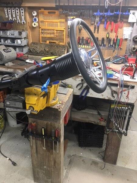

If you want a bolt in your choices are limited to Flaming River and Ididit I think. I can't stand either of those companies so I made one myself using a hot rod column, 33" I think. It isn't real hard but does take some work. The 2 main areas of concern are;
1. How it attaches to the dash frame support
2. how it attaches to the steering box
I used the original bracket from my old column along with the spot welded mounting blocks off the old column. Most of the hot rod columns are made of like a pot metal and I don't think you can weld to them so I made clamps that go around the column shaft.
for #2 I used a Borgensen adapter

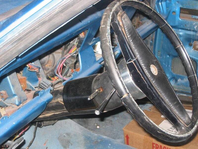

I used a stock crush can, they will go right onto the column BUT in the stock configuration the front lip of the can goes into the column housing so it is a seamless transition, on a hot rod column, the upper collar is smaller than the stock E body collar so you need to make a transition piece. This was probably the hardest thing for me to do.

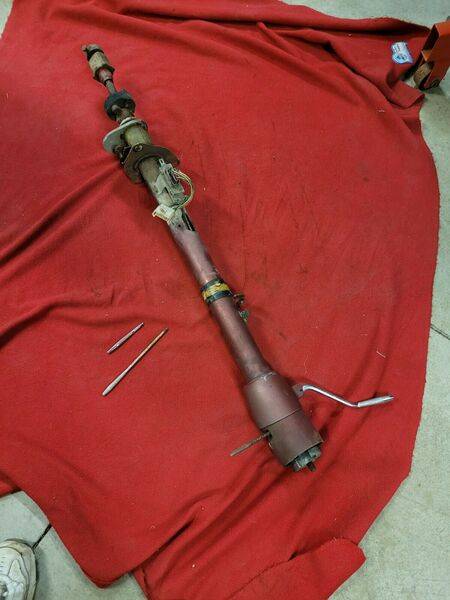

I have a tilt out of a 64 Chrysler Crown Coupe. Let Me dig it out and get some pics. You would have to change the shaft at a minimum. If you are interested let me know.
