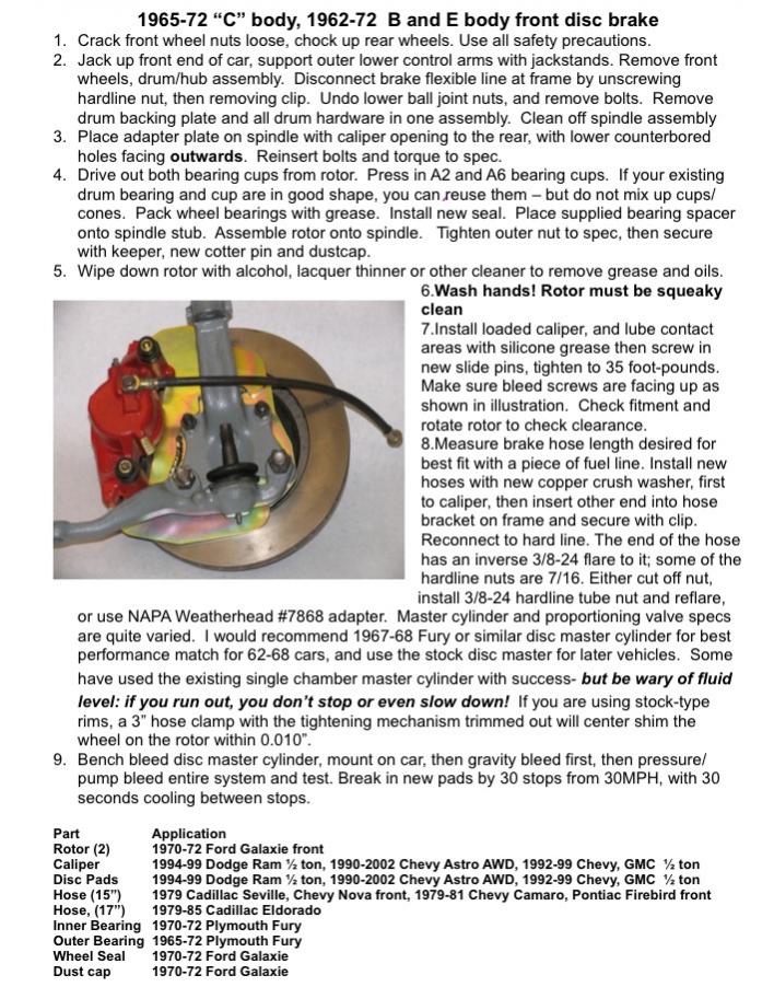

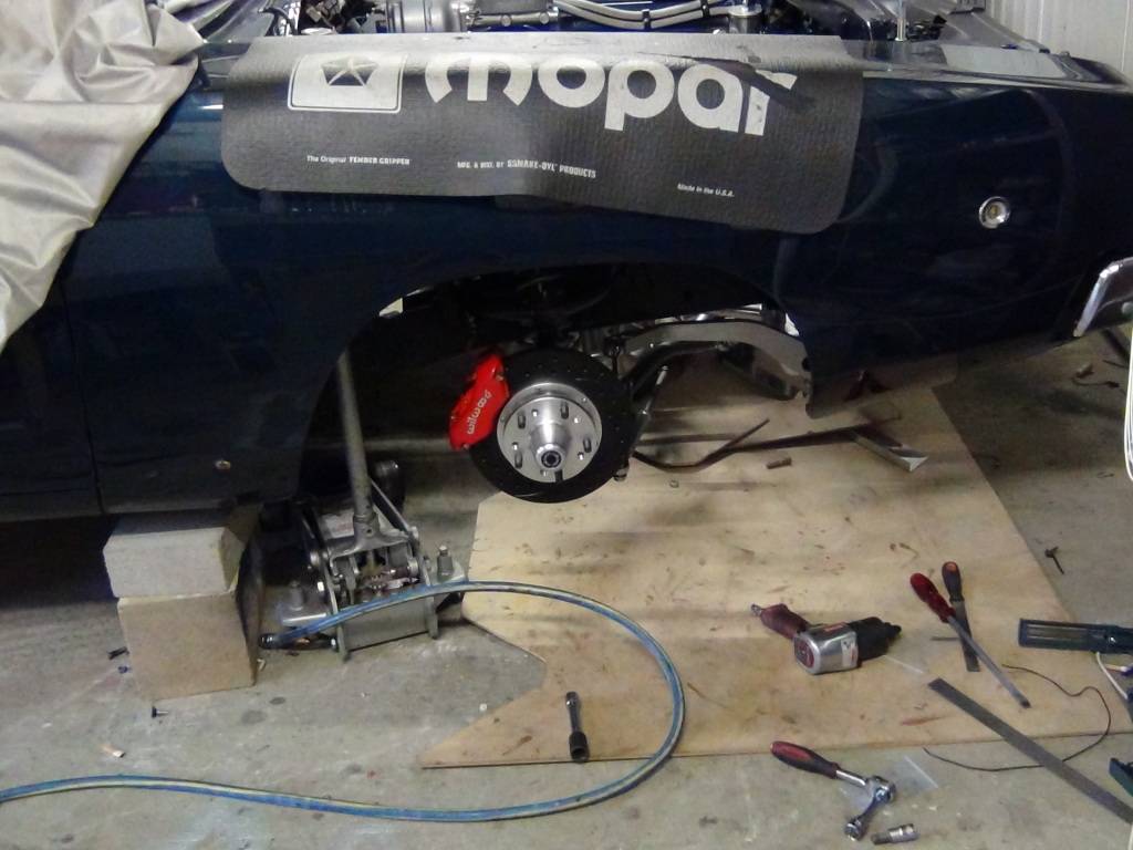

I just started my scarebird front disc install tonight. It'll take me a few weeks as I dont have much time to work on it, but I'll let you know how it goes. Rotors are $30 each for a 72 ford galaxy and calipers are from a 99 ram. Whole kit should cost like $450. I picked em up from a member here for less.
Here's the instructions and a photo. The only thing scarebird makes are the brackets and adaptor bushings. The ret are available at you local auto parts store.
only prob i ran into was even with the spacer they provided there was not enough threads to tighten up my rotor.solved it easy with a hardened washer from a local hardware store.

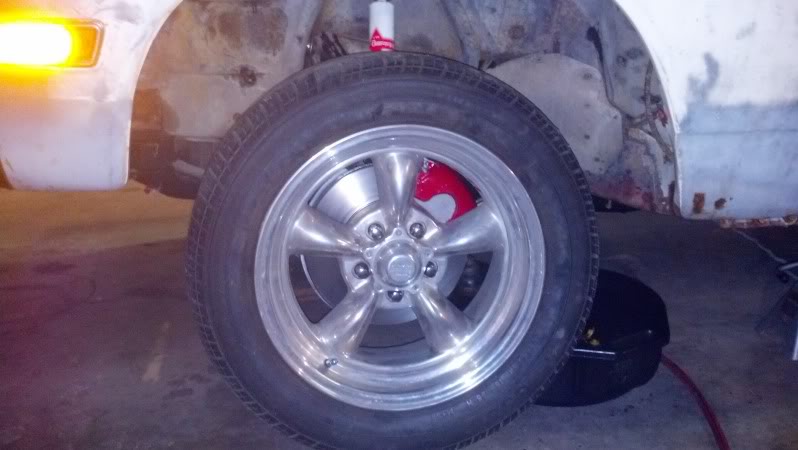

unless ur going road racing, stick with the 11 3/4 factory. JMO U can paint the factor calipers and they will look just like some aftermarket pieces to the untrained eye. 2012-08-18_23-33-34_886.jpg
These are 16's by the way. And the kit was $425 all chrysler parts!

ok, got it all together the other day and it all fit like a glove. I've been hesitating on which MC and prop valve to go woth, so I cant tell you yet how it drives.
67 coronet, i didnt have that problem at all - the spacers i have slid right on w a little help.

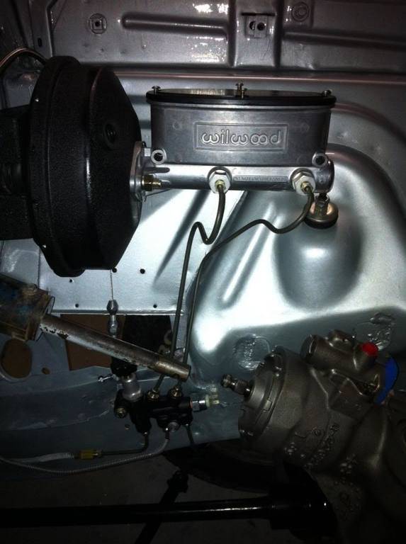

Mate if it helps, I got the SSBC kit for my 68 roadrunner, just with the standard disks and 4-pot calipers (no drilled or slotted). Cost me around $600 here in australia. It comes with an 11" booster I think and brackets to mount it. The iron master cylinder is complete junk though. I have since replaced with an alloy wilwood unit from Summit with 1" bore and it bolts straight up to the ssbc booster. Wilwood also make a combined prop valve / distribution block with built in brake light sensor, really tidy unit and gets rid of the brass block. It has 2 inlets for front and rear, 2 outlets for front (L and R) and a rear outlet with bias adjuster built in for the rear.
Let me know if you want any more details. If you could get just the rotors, calipers and booster from the SSBC kit you would be laughing, get the rest of the stuff from Summit.
