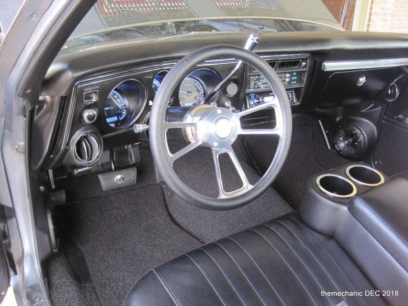

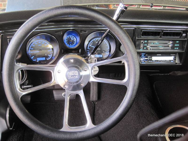

I found these guys https://fssteeringwheels.com/ and bought one of their wheels. They are way stronger than Grant. And, you can remove the front and change the looks. I put one on my 69 El Camino.
Currently they are running a Christmas sale. They also advertise via pop up window when you visit their site 10% off your first order.
Here's my El Camino
Here's a video on how tough they are built.
Here's my El Camino
View attachment 693409 View attachment 693410
That is an extremely clean interior on your Elk. Nice job. I'll check out the info.

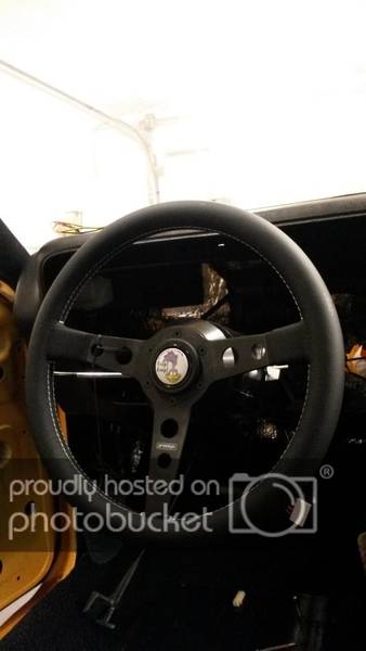

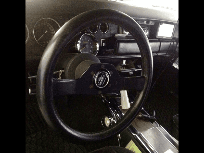

I installed the momo prototipo wheel on mine as I loved my momo on my AE86 so much, It may be because I have big mits so it feels right for me:

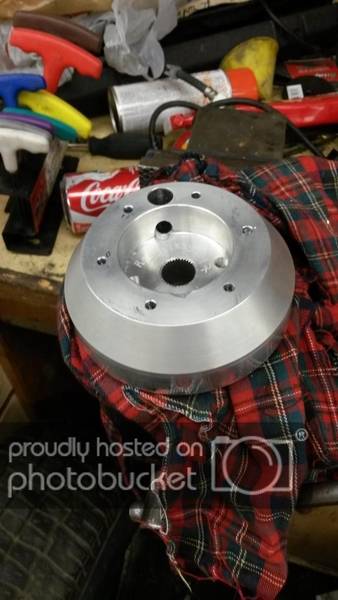

I took this hub I bought from classicindustries which is meant for a barracuda, it had the proper wheel hub and it makes use of the original horn:

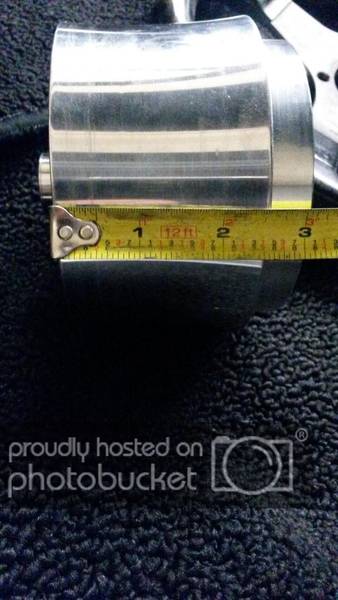

and had a machine shop shave it down to this and put the momo bolt pattern on:

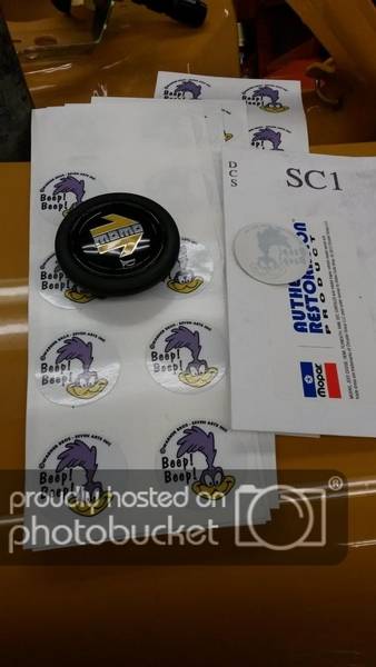

then had the local vinyl shop print these for my horn button:
All in all this project cost me about $400 to do
I love the Momo on mine. Johnnny Player Special. Sure would be nice to have the right Mopar designation in the center.

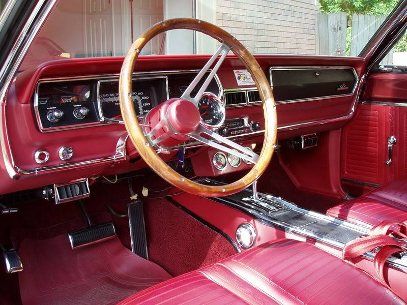

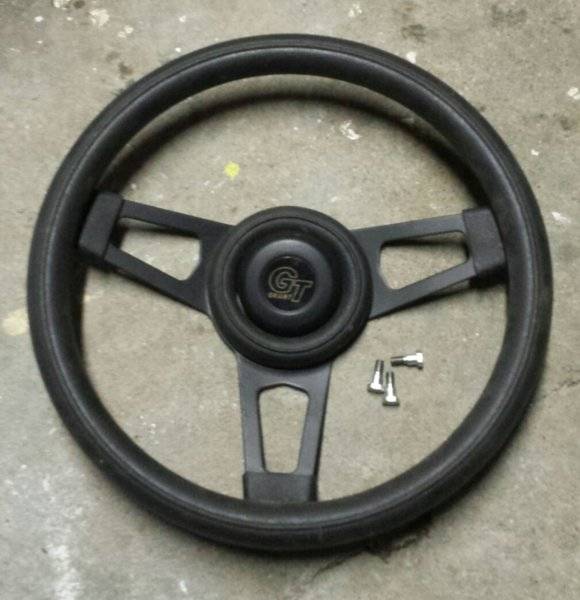

I found this one at Grant many years ago but have since returned to a stock wheel.
You came up with some great ideas. Nice
