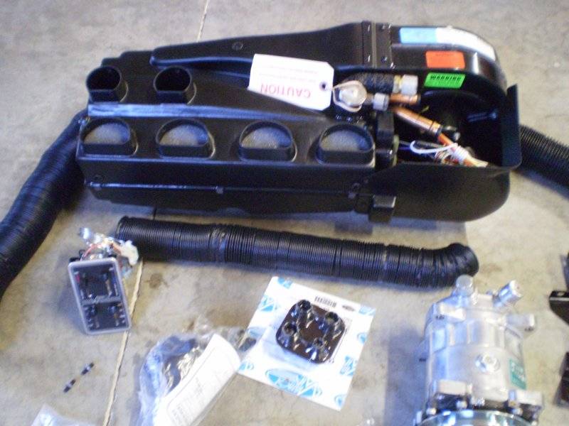

I am installing a Vintage Air system in my 1964 Dodge Polara, equipped with big block. My car had factory AC in it at one time that never worked, so I removed this system completely. This gave me the required pulleys and alternator mount. A bonus with the V.A. set-up is that it does away with all the vacuum hoses to operate the various doors. This is all done electrically on the V.A. system.

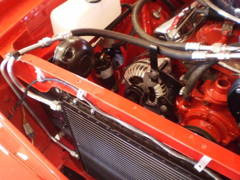

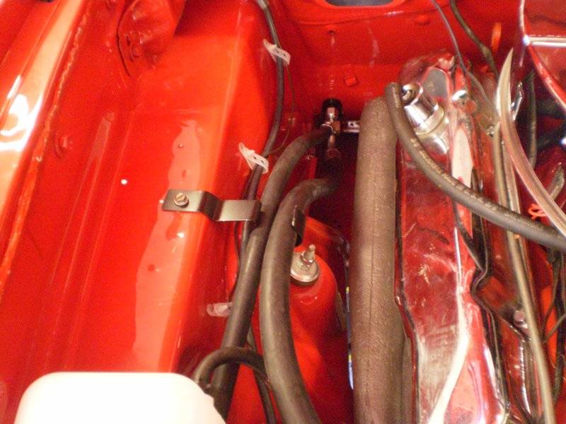

Like what you did with the heater hoses. Do you have any pictures of the right (passenger side) AC line connections from the interior view/ and exterior engine bay view) ? This is the Vintage Air GEN II Super AC-heat-defrost right? Thanks

Yes, this is my unit is as well. I will have to see what pictures I took. The last picture has to be rotated clockwise 90 degrees to make sense. I routed the AC hoses down the passenger side inner fenders using '66-'67 heater hose brackets. I bought hard lines and bent them with a tubing bender to go from condenser over the radiator support. I had to trim away some of the plastic housing on the right side to let various hoses enter that space easier. I can likely go through my invoices to sort out what parts I had to order to make this work. I also bought lengths of the 3 different sizes of AC hose, and had appropriate hose connections crimped on at an AC shop. I have not put my dash back in yet, so final wiring is not sorted out. Let me know what additional help I can give you. I also had to change the pictured thermostat housing to the early cast iron one that angles forward. This gave me room for the upper rad hose to clear the drive belts.

My Polara also had this air intake, which needs to be blocked off. Using the foam air intake gasket as a template, I cut out a piece of sheet metal as a block off. I ran a bead of black gasket sealer on the flange, and attached the cover plate with self-tapping screws.

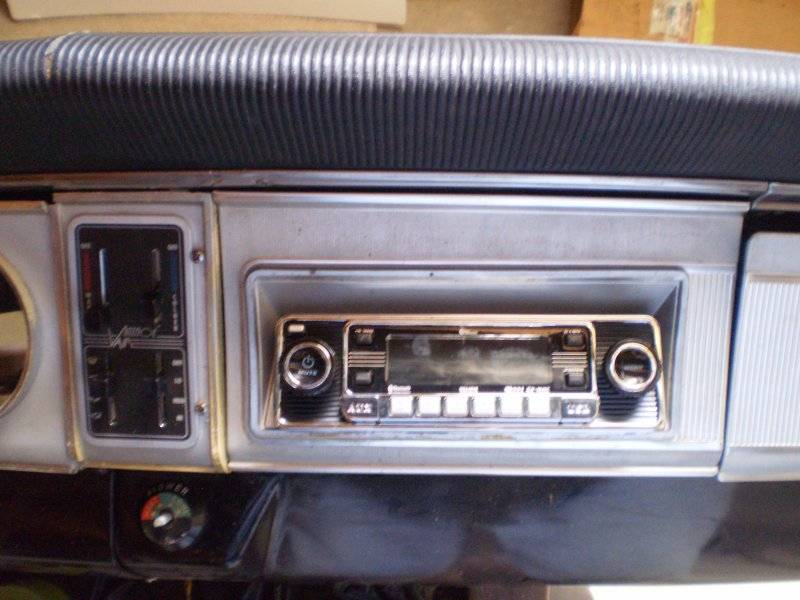

I was able to mount the control switches on the 1964 Dodge heater control plate by cutting out the original heater button hole area. I know the heater button arrangement is different on your Plymouth, so I don't know what you will do there. Dave.
