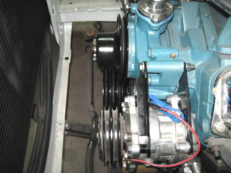

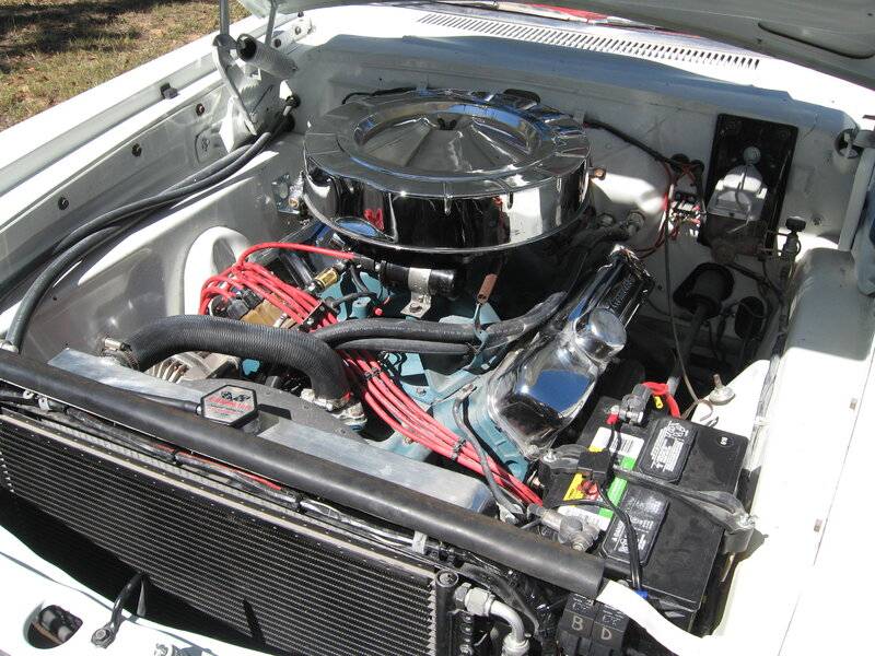

I installed vintage air in my 65. I mounted my compressor where the power steering pump would be. I used a Bouchillon performance bracket for the compressor and built the other brackets for the evaporator/heater box. Also the condenser and and drier. The A/C is cold and defrost works well.

Thanks Scott. What model of evaporator did you use? Did it clear the glove box, or did you have to modify it? What did you do with fresh outside air hole in passenger side kick panel area? Vintage Air lists engine brackets for mounting compressor above power steering pump. Vintage has so many options for compressor, hoses, etc., that I find it confusing. I think I will contact V A to see what hardware they supply for Surefit kit for '66 Coronet and modify that as needed. The rad support and engine sit further ahead of the cowl on a '64 than on a '66 so hoses would have to be longer. I already have factory air conditioning vents and engine pulleys.

I will get you some pictures of what we did

Thanks Scott. That would be great. I did underhood measurements of my '64 Polara vs. my '67 Coronet, which Vintage Air offers a kit for. It is an inch farther from the firewall to the rad support and power steering pump mount on the '64. Originally, I thought there would be more of a difference than this. I don't need vents, since I have factory ones. I think one of VA's switch panels could be made to mount on modified factory heater push button panel.

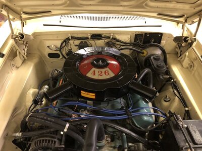

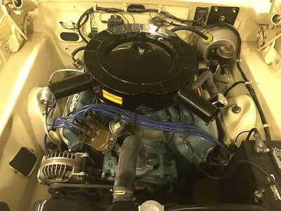

Obviously not a 64 but maybe some ideas?

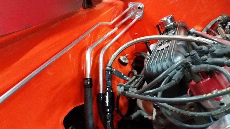

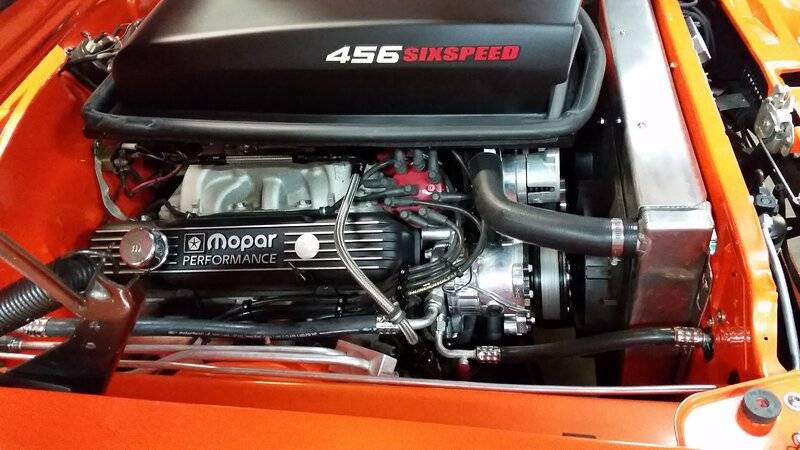

I installed Vintage Air in my Charger but went the custom route vs buying the kit, so far so good. In my case I was cleaning up the firewall and didn't want all of the extra holes plus wanted a cleaner install than the kit. As for the fresh air in the kit panel I got another driver side one and mounted it on the passenger side so now I have cable operated fresh air on both sides.
I chose to mount the AC pump on the passenger side so there would be no hoses dangling across the motor. The heater hoses were routed downward so they come in from the bottom also to keep them from dangling over the motor.

View attachment 1068104View attachment 1068106View attachment 1068108View attachment 1068109
Thank you. A very tidy installation, but more custom than I intend. Very nice looking underhood area.

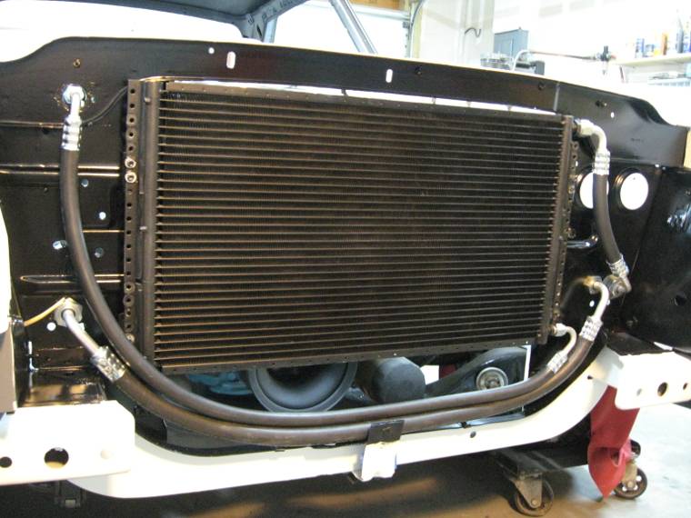

Here is a before the air kit and an after the air install. I went through the inner fender on passenger side. Made a new panel on fender and at the fresh air vent

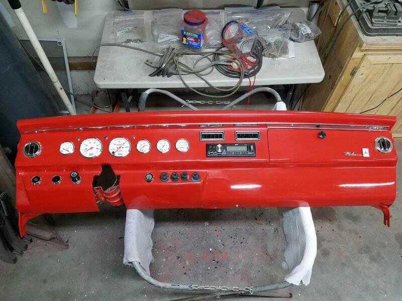

I used a Vintage Air Gen II - Heat Cool and Defrost unit on my '64 Polara. I also used a Bouchillon performance bracket for the compressor which mounts it where the power steering pump usually sits.
The unit was easy to install and only required minor fabrication. My car didn't have AC originally so I had to modify the dash for the vents which required narrowing the glove box door but the finished product looks damn nice.
