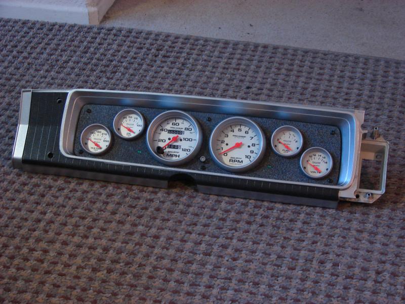

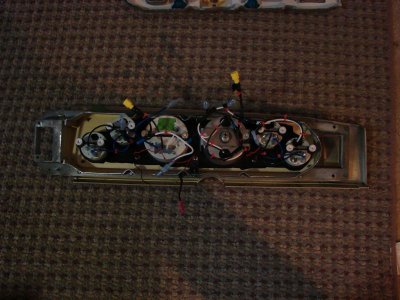

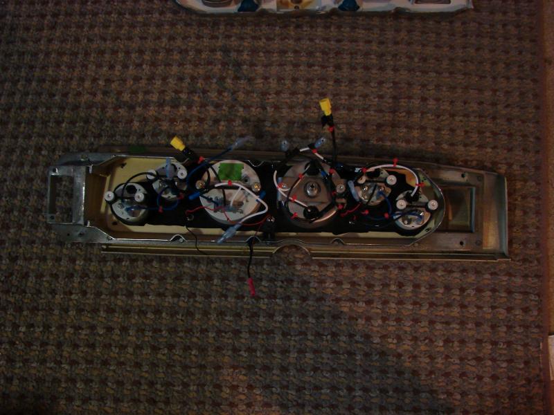

Here's what I did with my Auto Meter gauges:
Thank you. Im thinking of going with the stock dash harness and buying the gauge wiring kit from autometer. Not sure what other modifications i have to do to the dash harness but seems the easiest route.
I recommend buying a relay circuit for running a set of aftermarket gauges so you can provide individual power to each gauge. The factory fusebox isn't great for aftermarket components, and even on a more modern car I had I noticed that pressing the brake affected a couple of my add-on gauges. When I did my Auto Meter, I bought a 7 circuit relay that was connected directly to the battery with 4 'switched' relays to power my gauges. Plan it out first - make drawings of the gauges and draw each wire and determine where they will go. That's how I've always laid out my wiring. But then, I'm one of those people who loves to do electrical work on a car where most people I've met hate it. LOL

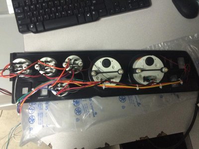

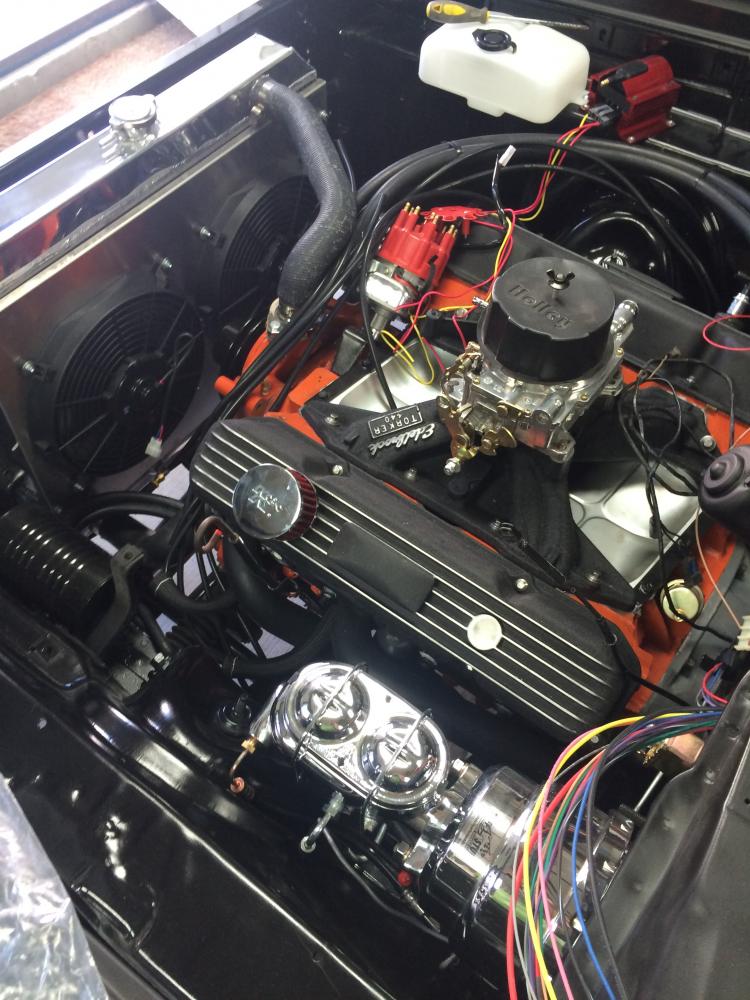

yes I have taking all factory wiring out and replaced it with a 21 circuit painless mopar harness. I also have all autometer electric gauges with sensors, even used the speedo VVS from autometer no more cables. it works great just gotta take your time and really read it the directions, if u have issues I can help as mine is all wired up and working greatView attachment 2888192015-05-30 17.05.21.jpg2015-08-30 15.31.05.jpg

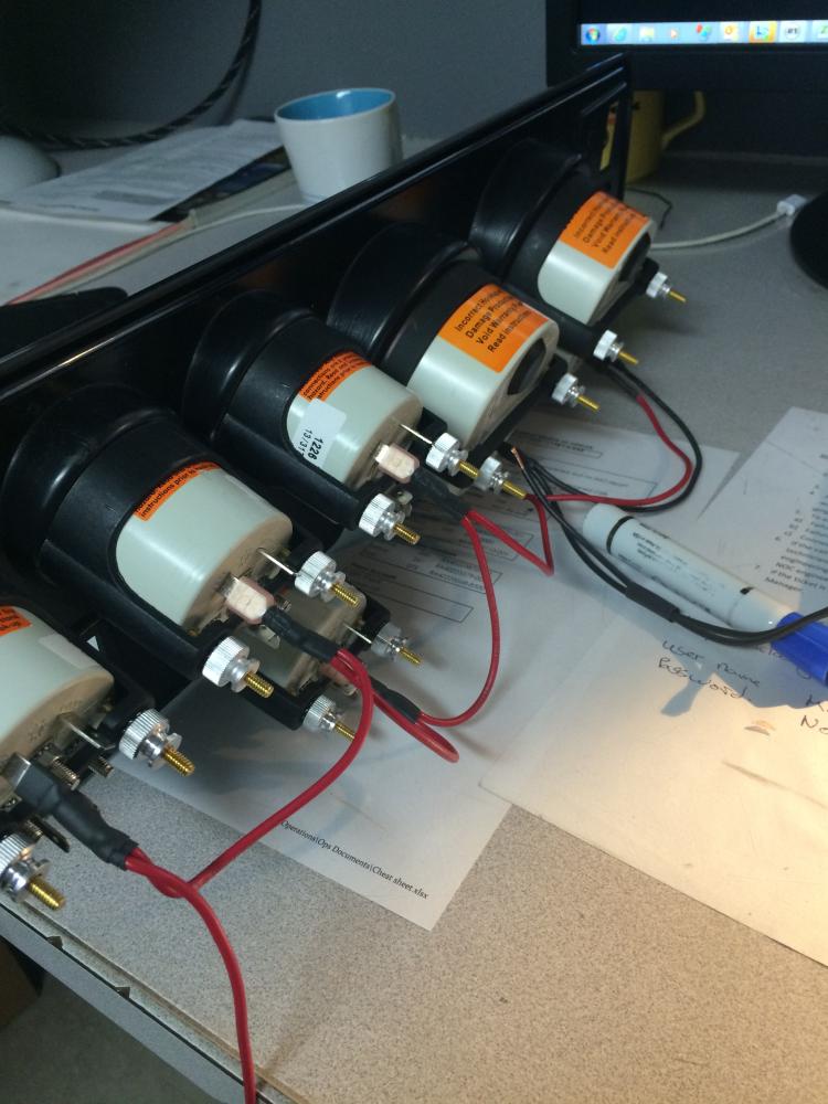

to keep from jumping piggy back from guage to guage,I just installed a few bus bars(available from fry's)on the back of my dash.1 power wire,split to each guage.made for a much more stable power supply to each guage.did the same with ground and lights.there should be picks on my profile.dont have any pics on this computer.
