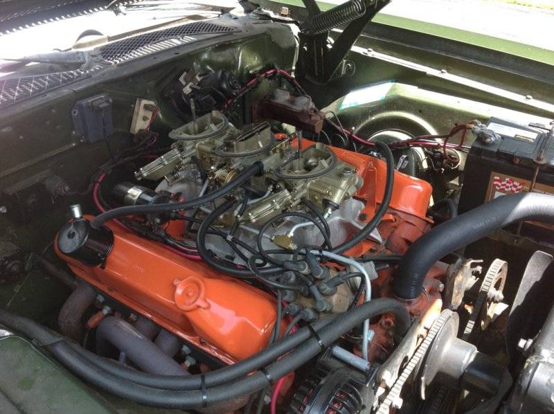

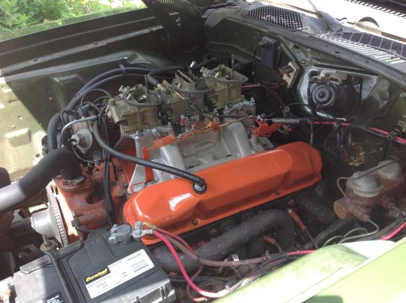

Hi,
I just installed a Herb's 6-pack kit this spring on my 72 440 RR and it went great !! If you buy it make dang sure to do a inventory of the parts you get to make sure you get them all - Herb's did a great job but they missed a few parts and after emailing them I had them without issue. Do your homework on installing the six pack (I got all the needed info here) I did the whole install myself and so far the car runs excellent. If you have any questions just ask.
I am 100% satisfied with the kit and Herb's !!!!!!!
(pics attached)
Very nice, nothing runs like a six barrel (Plymouth) the Dodge six pack is almost as good .....perhaps you should have painted it to match the engine b4 installing??? A little critism (or sarcasm...if you prefer)...change the driver's side valve cover and reroute the PCV hose around behind the rear carb to the inlet on the center carb...... Just my opinion of course.
BTW....Tony's Parts is another good source for Mopar stuff.
Bob Renton
