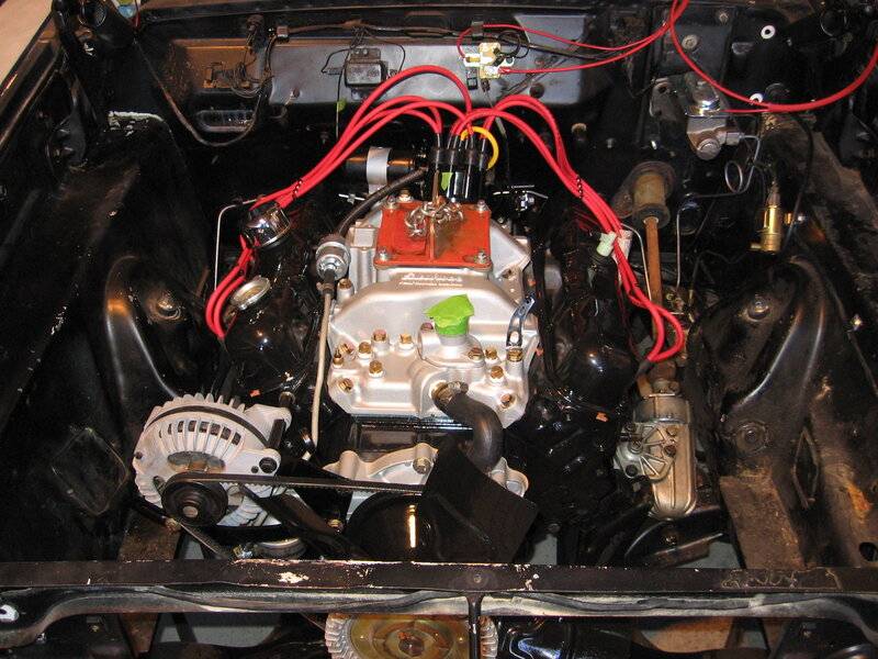

Take a look at the Edelbrock performer (Jegs #350-2176) It has the offset thermostat with dual pattern and should have the bosses for all the bolt holes
Here is a photo of one on a LA 318.
It's also got plenty of places to put that heater hose nipple, which could come in handy.
