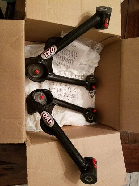

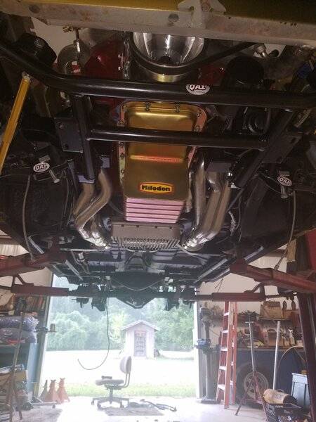

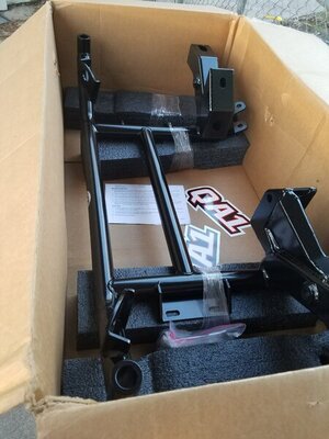

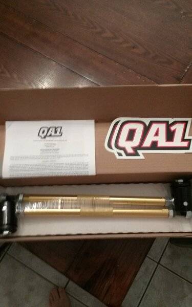

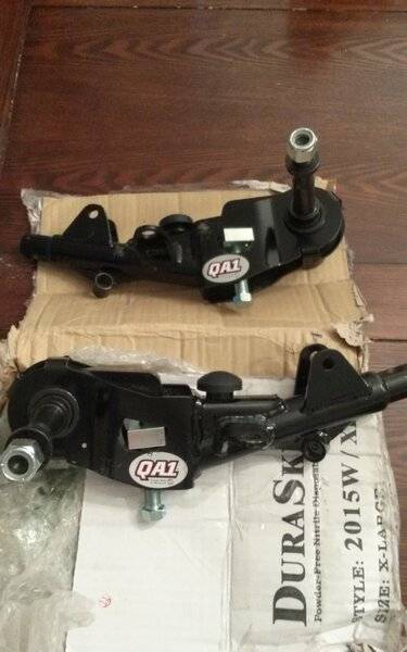

I have a QA1 w/uppers & lowers & strut rods. Upgraded PST torsion bars and Borgenson steering box. Everything looks to be good quality, havent had on the street yet... but I'm hopeful it does well!
Looks awesome! Looks like you can actually get the oil filter out without beating everything up too!
I think you will be impressed. I have similar setup except my uppers are SPC adjustable and also the PST 1.03 TB and this thing tracks excellent and turns on a dime.
That ( accessibilty), is probably my favorite feature as it sits!!!! Hopefully I'm equally impressed with the drive characteristics as well!
