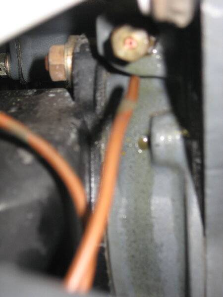

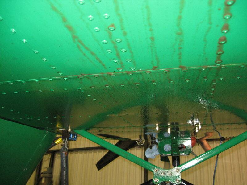

That said, bronze/copper breaks too from vibration! Luckily I still had a couple quarts of oil left when I landed at home on this one... why you ALWAYS should put a restricted orifice in an oil pressure line fitting !
