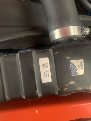

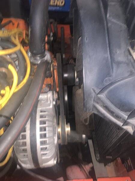

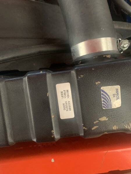

Hey all. My 1969 roadrunner came with a aftermarket radiator and hacked up shroud. It works and says cool but I’d like to clean it up and get a shroud that fits. Has anyone used this radiator before? Thanks for your help
Mac
818DF1EA-EBDF-4DF4-A0EA-70B965C8763F.jpeg 2A48F750-3FA1-432F-ADEF-C978CFCF5276.jpeg
It looks like your radiator has a flange on the sides like all other radiators. Any factory reproduction shroud of that model will work. You will have to pull the radiator and place new shroud on it and then drill holes in radiator flanges to match holes in shroud. Pretty simple.
