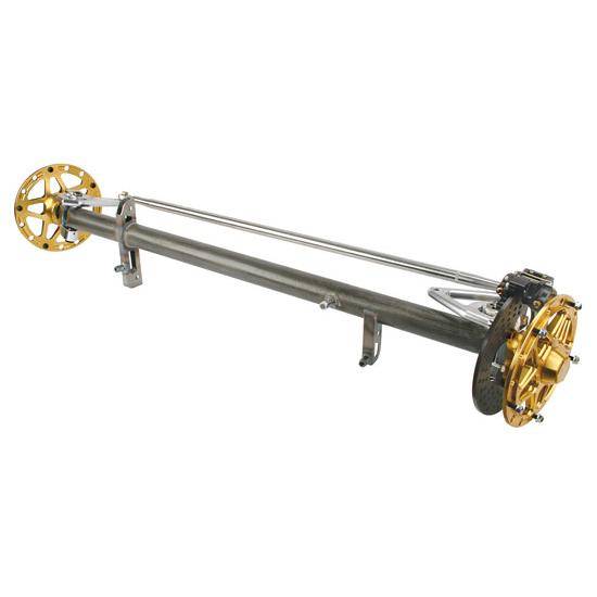

Try Speedway Motors IIRC they have a couple straight axle to chose from...
https://www.speedwaymotors.com/Search?query=Straight+axle
go down that page about 1/4 or 1/2 of the way
they ain't cheap, $849.99 one brake, you could adapt 2 brakes
IIRC you can piece meal, that axle too, just need to do a search

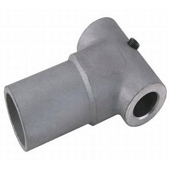

you could buy ends for the spindles
weld them to a tube for your specific width,
they have different sizes for different type of spindles too
Just weld on the proper perches at the proper angles
