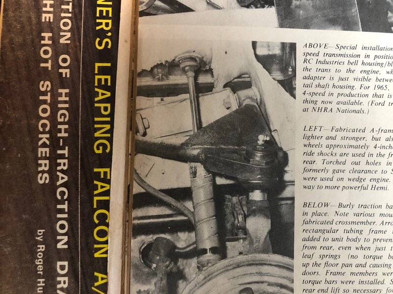

          This is the 2% offset control arm to match the moved forward 4" approximately, K member

            I might add that you also need the appropriately lengthened torsion bars

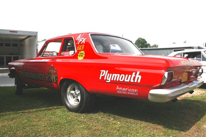

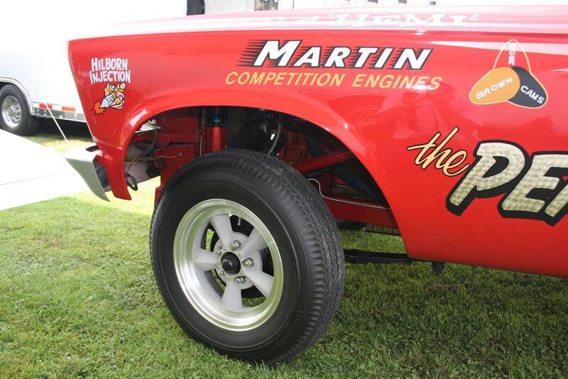

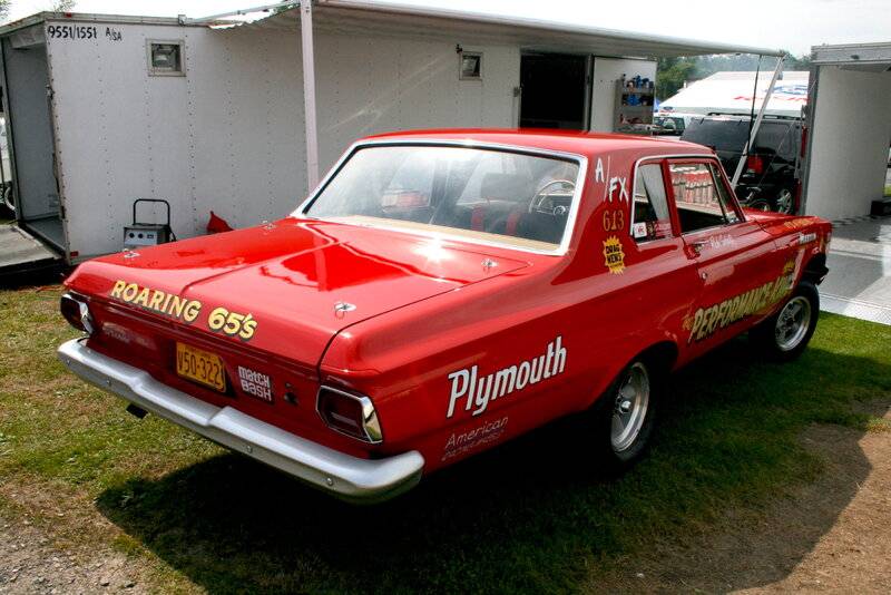

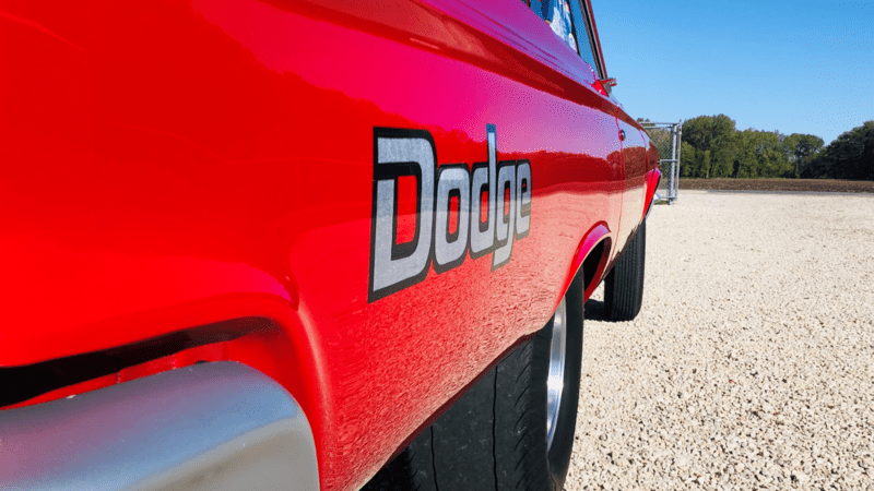

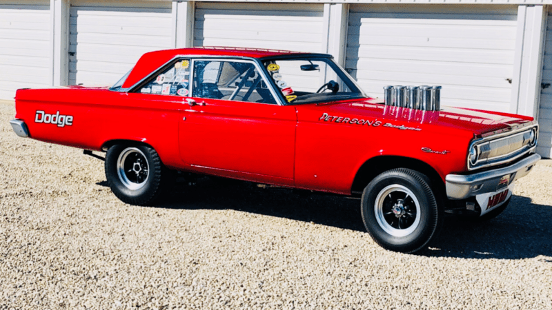

                          We like 'em pretty :)
