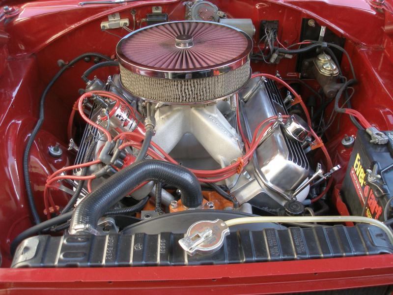

i'm running an Edelbrock "Victor" intake on my 69 RR with no clearance issues, albeit, not using the air grabber system or hood insulation either. P5161100.jpg
