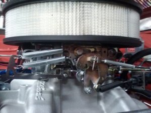

Have an Edelbrock RPM intake, Quick Fuel carb on my 400. Also have a Mopar Performance air cleaner. I'm sure someone has ran into fitment/clearance issue, for the hood, and what you did to remedy it. Is there a different base to use for the air cleaner? '71 B body. I'm not at home right at the moment. I have a good friend who is giving a helping hand since I'm deployed and he put my hood on, running into this issue. Thoughts/advice?

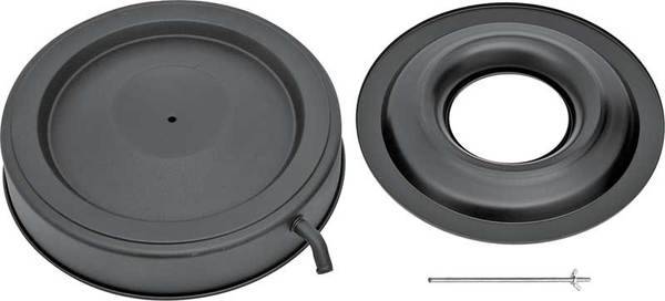

If your using an unsilenced air cleaner here ya go!
http://www.manciniracing.com/mara13aircld.html

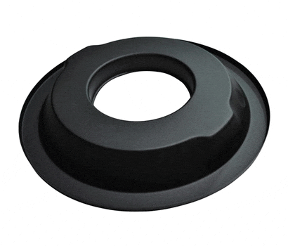

You need a 1.25" drop base. Don't think they are made for the mp filters though. Go to a 14" and there are several possibilities.
See my post above yours......made for the 13" mopar air cleaner.

Cool. That's a new product that wasn't available a few years ago when I was dealing with this issue.
Apologies, thought you said eddy carb, missed the QF part. I have Holley with electric choke and that fit great. Supposed to be one of the least restrictive drop bases there are.
My Quick Fuel, 4 bbl, is now ran by Holley. The link you posted says "Does not fit Edelbrock carbs with electric choke". My QF carb has electric choke
No worries on my end. I appreciate the info. I just need to drop it about an inch(?)

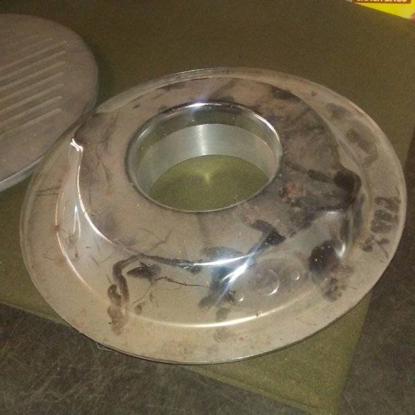

Rod, I have a few bases in my stash. Let me know if you or your on-site assembler need pics.
I appreciate it, Leanna. Send me pictures please, or post them. I have an "unsilenced air cleaner". Nothing goes to it, just opened to the atmosphere like in the photo I posted. In fact, Leanna did my powder coating for it :lol:. I just need to drop it by an inch or so. It might come down to a different base and slightly shorter filter as well, don't know
Let me ask Billy -- they arent where I left 'em. Probably snagged up for a project when I wasn't looking ... I could pay him back by offering up the Lil John's one heh hehhhhhh but it's part of a SBC set.
Let me ask Billy -- they arent where I left 'em. Probably snagged up for a project when I wasn't looking ... I could pay him back by offering up the Lil John's one heh hehhhhhh but it's part of a SBC set. View attachment 563187
That's the same one from Mancini and what member 91r/t posted except yours is plain aluminum and Mancini is powder coated. Thanks Leanna!
Thanks for the link, 91r/t. Going to give Mancini a call tomorrow. Bound and determined to get this figured out
