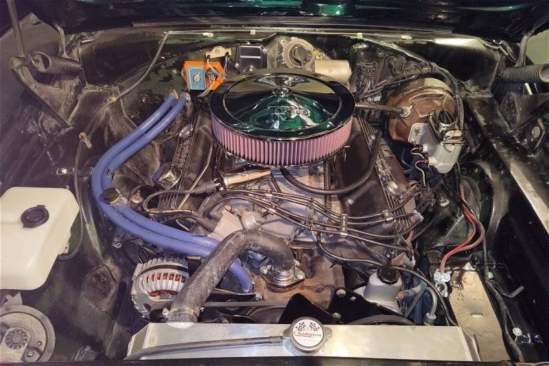

Hi all! My 440 is almost complete, and I am starting to look for finishing touches. Getting this out of the way early, I am not going for factory correct, just going for an overall attractive build.
I am running a dual-quad Edelbrock setup, which currently has a supremely average looking stamped chrome air cleaner plopped on top. See the pic below for reference. In all of my searches, I have only come across two air cleaners that I think would look good, but wanted to see if anyone on here had other options in the same vein.
Of course the dream is the factory hemi style air cleaner. I love how large it is, and I think it could really look nice on there, but I doubt the carb spacing is the same, and I don't have the budget to spend $1000 on an air cleaner. The second is this one sold by Edelbrock which is better price wise. I think that with a set of the black Mopar Performance finned valve covers would look decent.

The oval ones look the best I think. 2 single round cleaners look kind of goofy and don't move much air. The early 60's ones look cool but they would look out of place on yours. dual quad 440 - Google Search
What body style are you putting it in. The early gold "football" aircleaners are cool, but wouldn't look right on a 67-up. ( and real ones are WAY expensive, I'm thinking about the fiberglass repops. )
You could maybe dress up the a/c you've got with a custom decal (440-8bbl). But I do like the edelbrock a/c you referenced
Either way, stick with the single oval instead of two tiny round ones.

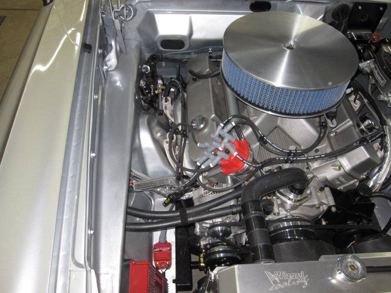

You could build one. If you like the large round Hemi style, a large round base plate would be a piece of cake to fabricate. I have a plain aluminum top on my 540 in a 16" diameter size. I purchased the 2 piece air cleaner from ramairbox.com in
Canada. I think that may work with 2-4s. That style top could be custom painted any way you can dream up!

Should have called that out, sorry. It is going in my '66 Charger. I definitely want the single large air cleaner look for this build.
Mike
I like your flat top plate with the recess for the wingnut, this alone would give you an extra half-inch to an inch or more. Was that something you fabricated or part of a complete assembly from Ramairbox? I would dig one of those in 14". I'm using a K & N 14 x 3" air cleaner, a 1" plastic spacer beneath it, and a 3/4" carb spacer. It all barely fits under the hood of my '70 Charger.
