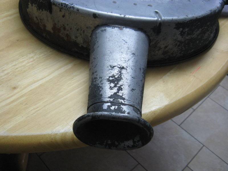

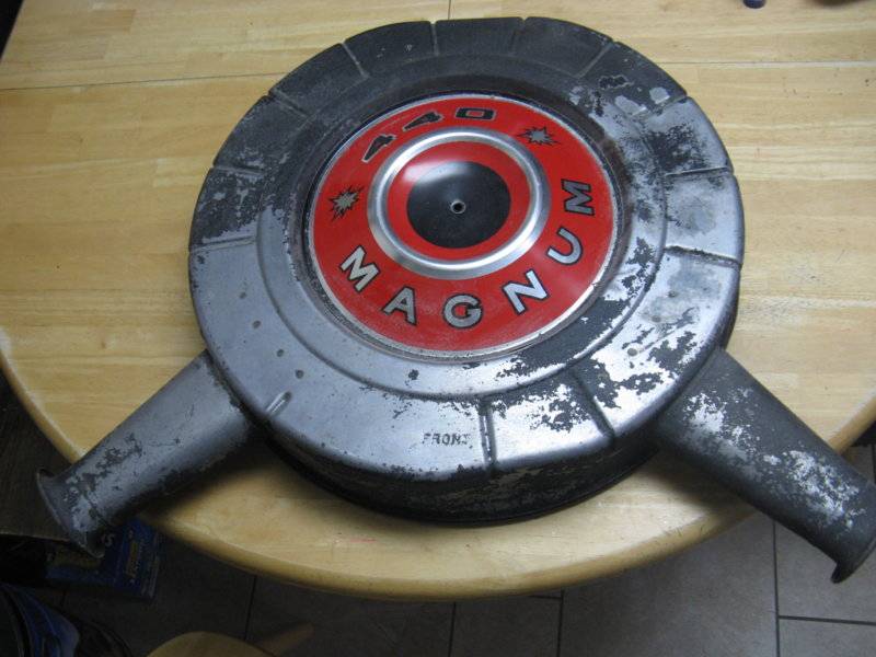

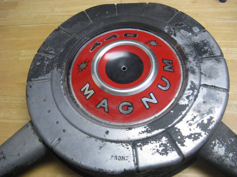

I have a bunch of Air Cleaners. This is an original wrinkle finish Dual Snorkel air cleaner from a 67 R/T.... I believe this unsilenced air cleaner also came on some 67 B-bodies and is an original wrinkle finish from a 67 383 Barracuda..

For 67 440 the CAP version was just a hose nipple off the left, rear part, snorkel. I’ve never seen a dual snorkel in 67 be different from AC to no AC.

I believe the first picture in Quickbpbp post 24 is the correct one for 67 440 I was told that they had 13 ribs on the cover , in my journeys looking for one for my rt all I could find were covers with 12 ribs . Just what I was told.

Correct you are....have both 67 factory 440HP and 383 4 bbl cars. 440=oval 383=round

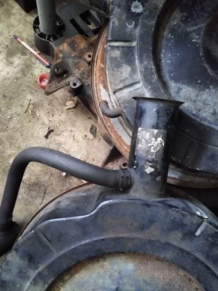

I have a 66 CAP and non CAP single snorkel for sale, I want to sell the CAP. The difference seems to be where the breather hooks up. Anyone know which is which?

CAP has a hose nipple for a hose to breather and NON Cap has no nipple on air cleaner....

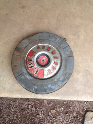

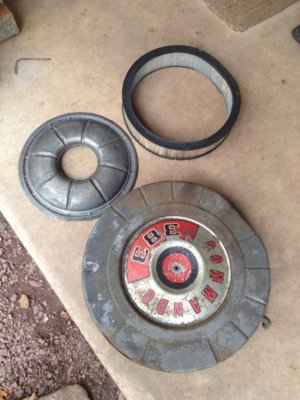

Interesting, then what do I have here? Super rare, 1 week only, drag strip testing air cleaner...:) I have no idea. Both 66 383-4. One is California
QuickBpBp
8:51 AM
Oct 14, 2010
12,210
37,255
SE PA
I don't believe the Cleaner Air Package was California only....

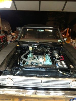

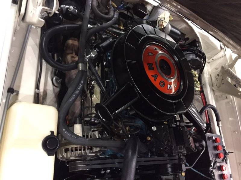

This pic is of a 67 440 XP29L car that was presented as all original parts, I questioned the tapered snorkel oval tips and the very knowledgeable owner promised me it was factory. This car was at show at the IX center in Cleveland OH in 2018 or so.

Correct me if I'm wrong, But I do believe that the 66 base was 4 7/8" and the 67 base was 5 1/8''. Or maybe the 68 was the first year for the 5 1/8'' base.
While looking for a dual snorkel for my 67, it did appear that 68 was the start year for the 5 inch base.
