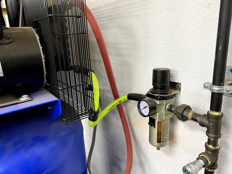

May have posted this before, I installed an evaporator on the compressor not long after my OP and a fan (not in the photo). It helped, but not greatly. I have the compressor on a cart so I can move it btw garages - to heated garage during winter. The line routing as mentioned above is my next to do when I get some other projects out of the way.
I see whay appears to be an air cooler (the radiator) but I don't see anything that would be called an evaporator. That rad does nothing to remove moisture out of the intake air.

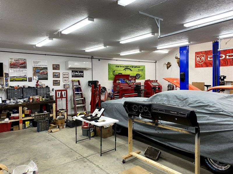

Here is my setup, A separator fed to a iron tee with a drop. the pipe runs up and across the wall with a pitch back to the compressor and each drop has a riser to the drop with a separator on a t with a drain. You can see the line across the top of the wall in the second pic.
