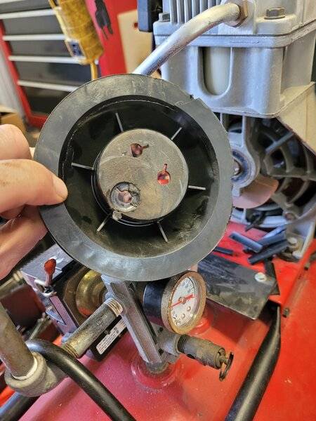

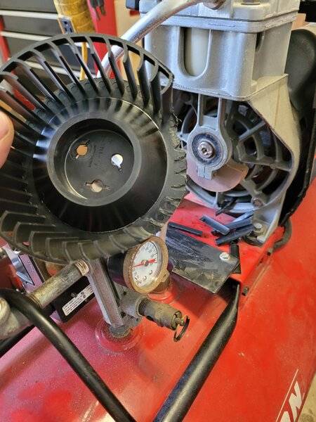

Looking for input on whether to try to repair my 25 yr old Craftsman (DeVilbuss) air compressor. It is a 3.5 hp 25 gal unit. Today it ate the new fan cage I put on it less than a year ago after it ate the original and I have only used it a dozen times or so since. The retaining screw was still tight, but the keyway, which is only on the back face and doesn't go all the way through the thickness, is spun/stripped. I can buy another cage, but there must be something causing the cage to chew up its keyway which then allows it to smack the tank.
The motor and/or compressor has started surging sometimes whereas it used to run a steady rpm. All that has me thinking it might be time to just get a new one unless there's a relatively cheap and easy fix.

Why is the fans mounting hole off set? The hole should be in the center of the fan hub to go on the armature's shaft end. Or am I missing something??
I'm guessing because it's mounted to the throw on the crankshaft not the center, mounting it off center would make it spin true.
I see that now. Ugh looks like a POS to me.
It was cheap so I could afford it at the time lol and it has served me well, but I haven't used it heavily in a long time. I definitely want to get something more capable. Thanks for the suggestion @Ironbuilt

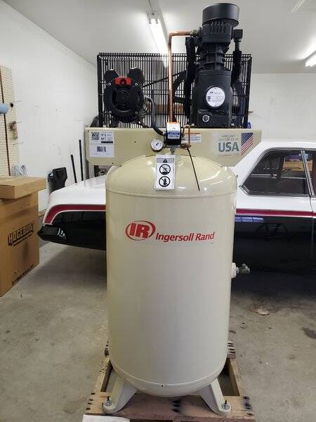

Looks like the same one I got from Tractor Supply. 220 single phase compressor or dual?
Yep, Tractor Supply. 5HP 220 v 80 gallon tank.
I love it. I plumbed the whole shop with the Rapidair system and I couldn't be happier.
