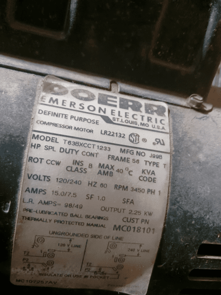

Here's a pic of the motor....I'm guessing this is the start capacitor under the cover? There is a smaller cover and I'm guessing it's a run capacitor? The pic he sent shows two....one larger cover and the other is smaller but looks like the pic is too big to get it all in here This off of a friend's compressor and I haven't laid hands on it. I'm a bit lite on electrical stuff but have replaced capacitors on AC units before but never messed with electric motors like this. He said it'll run if he helps roll the pulley and it runs like it always has but won't start on it's own.

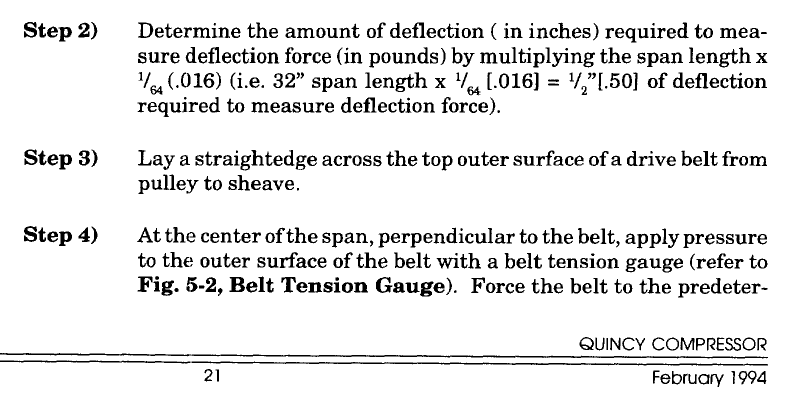

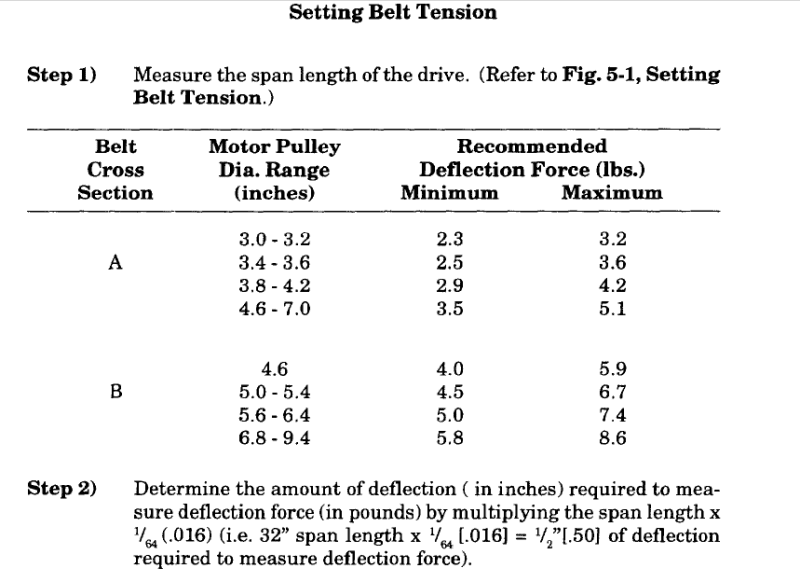

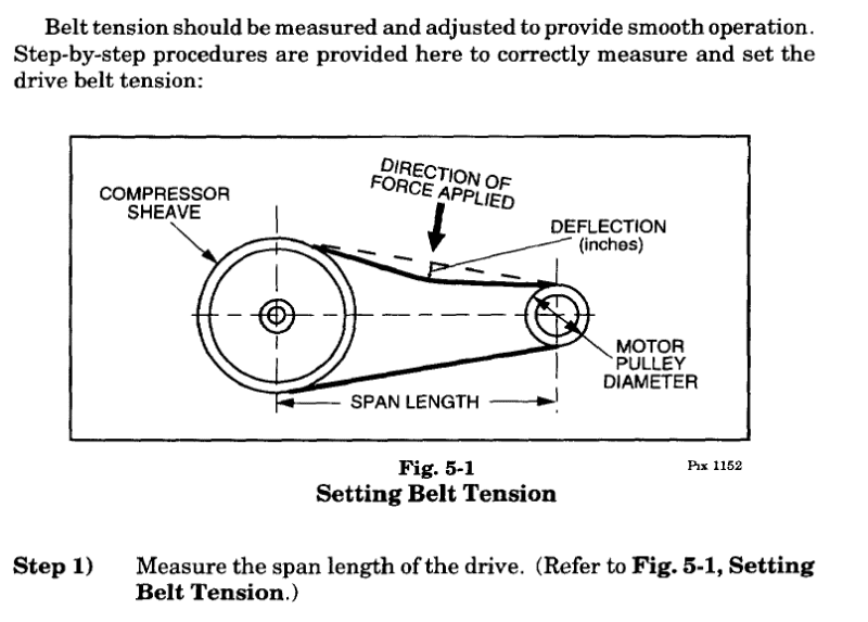

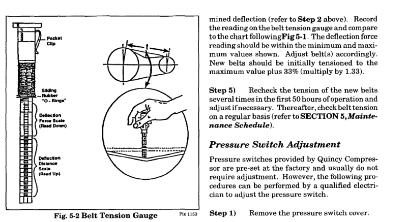

From the Quincy Manual...
What was up with the belts?
They was oooooold, stretched and slippin. They had to have been at least 20 years old by the time I was gifted it in 2006.
Now I have a happy little compressor again. lol

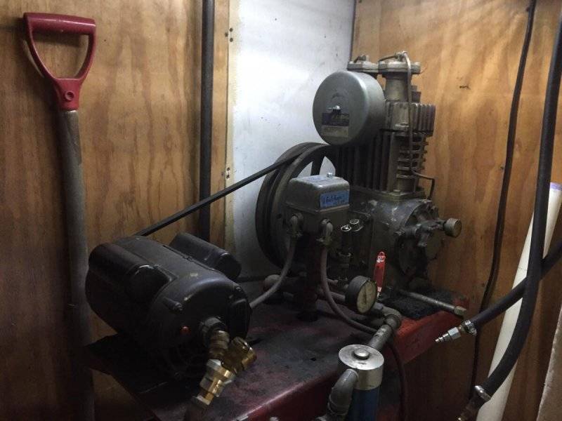

Found my thread...
Lots of shenanigans, but problem solved. lol
