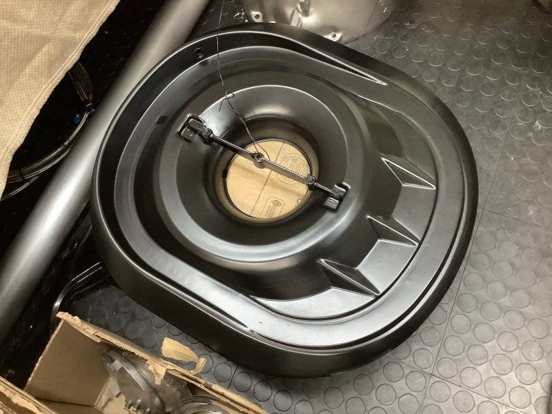

I have an NOS one I can photo.

I bought an nos base for the air cleaner.
And was gloss black .
