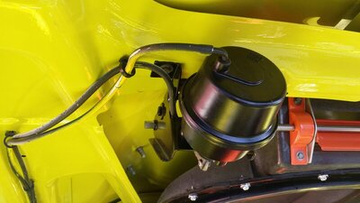

There are 4 screws that secure the actuator bracket to the underside of the hood.

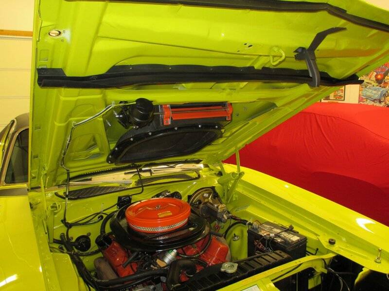

I am piecing together my ramcharger setup and am not sure what to use. Any help would be appreciated. Not my pic.
They use a hex head bolt with a captive spinning washer. By memory I believe it's 1/4" thread, the welded nuts in the hood will confirm that. They are probably the same bolt as the "SEM" bolt that should be in the side of the actuator bracket. RT Specialties should sell them or Frank Badalson/Roger Gibson.
Ron
The bolts that hold your hood safety on would be correct looking also.
Ron
