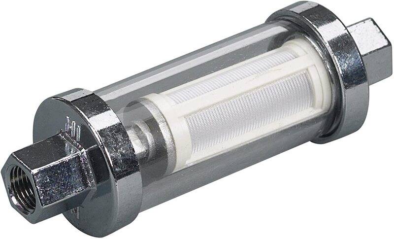

This is 1st time I've ever used a clear plastic filter and I have used it for a couple of years now. I got it so I can see how much crap has accumulated. From the beginning I noticed their was air in the filter but the engine seemed to run ok. Is it normal to observe this condition or is this a problem? Thanks
As far as I know this is common. I seldom use the clear filters, but have seen it before.
Air in the fuel system isn't like air in the brake system. So long as the carb bowls are full, the engine doesn't care.
just my 2 cents worth...I always thought the space you see in a clear filter when it is 3/4 full was filled with gas vapors and that way you always have a full filter. That way you still have a continues flow of gas while the car is running.
It is normal but defies logic to me.
It seems to me that the filter should be full of gas since the system is pressurized.
Thanks to all, it's nice to find out I don't have another mystery to solve. It's like getting a day off for free.

The void space you see is actually fuel vapor not air. In the OEM fuel system used on the Hemi and Six Barrel engines, use a "fuel vapor seperator" to insure that the carbs receive only liquid.

If the fuel filter was mounted straight up and down, I don't think you could have that air gap. Mounted at an angle , I think you would have air trapped in the corner. ........................MO

A carbed fuel system pressure is probably around 6 psi but the reid vapor pressure of the fuel is 7 psi or greater depending on winter/summer grade and temperature.

It's pressurized between the pump and the bowls....

It is very normal as the filter is NEVER filled solid with liquid.
