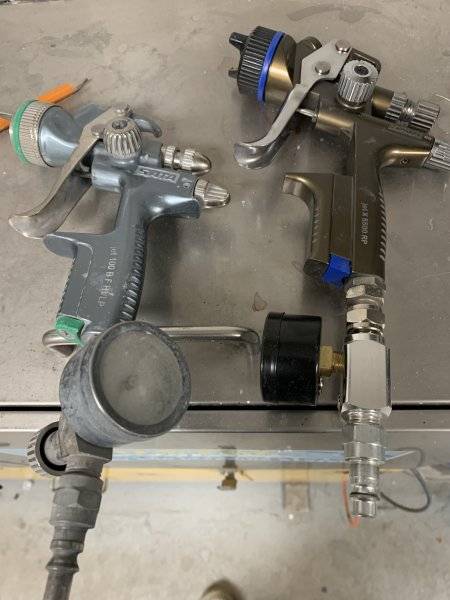

I never shoot primer through the same type of gun that I shoot color/clear. The difference is
amazing if you spray primer with a cheap primer gun! You can do a whole car in three minutes.
The other key with using 3/8" hose is using the high flow fittings.
slimt
2:30 PM
Apr 17, 2017
4,663
5,580
Alberta
One the right Base, or Clear with a 1.3 tip. Also have the 1.4 tip Sata RPs as well Hvlp fittings.
One on the left. Just a 100 Sata. With a 1.8 tip for primer. Standard fitting
