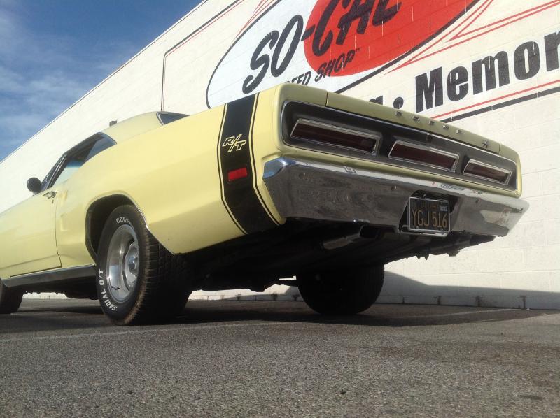

image.jpgThese are 295-50 15's on 8 inch stock rims. A single leaf from Summit inserted on each side. Bilstein Mopar-tuned shocks from Hotchkiss. Gave about a one inch lift. The 295's fit before the lift.
