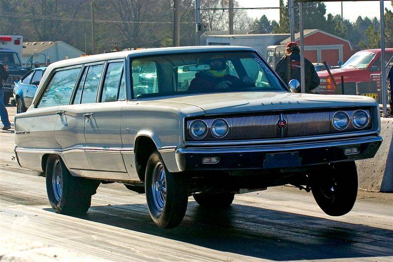

From personal experience, I've used air shocks in several different cars since 1972, installed them in customers cars ( including station wagons ! ), and have known others with air shocks in their cars. And never, not once, have I've seen a shock mount break. Ever.
This pig had S/S springs, no snubber and airshocks, with separate lines to preload the suspension. Never broke a thing....and it seemed to work okay.
