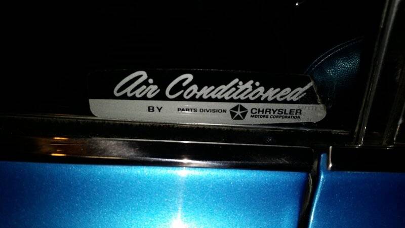

I hear ya. For what it's worth, my '70 Roadrunner has its original Airtemp sticker. Like Dennis mentioned, it's on the passenger side rear (quarter glass), low and near the back. I can send a photo if helpful, but it's not a '65 Savoy...

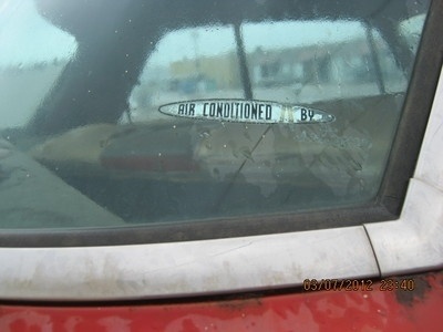

Thanks for digging! That's a good lead, I assumed that's where it goes. Only trouble is, there's an old state farm ins. sticker in that corner

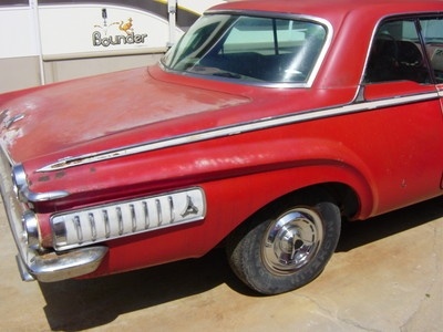

Here is mine from my 62 polara 500 .original
