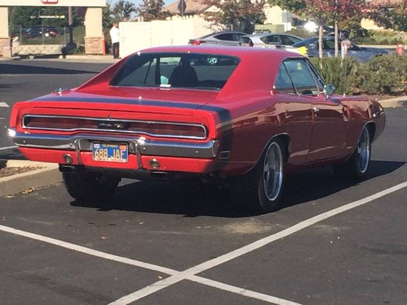

My Charger has stock UCAs and the offset bushings. I have 4 1/2 degrees of caster and .75 degrees of NEGative camber.
