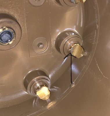

I spoke to Summit and they are sending another distributor to try. Here is a pic of what I mean. This motor has at least 5 hours of run time and you can see where the arc is jumping to the terminal. I drew the black arrow and it shows the arc dust and how the rotor seems to have scraped the terminals.

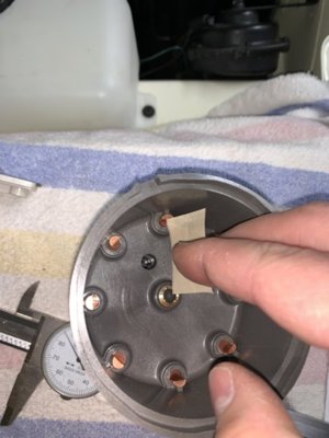

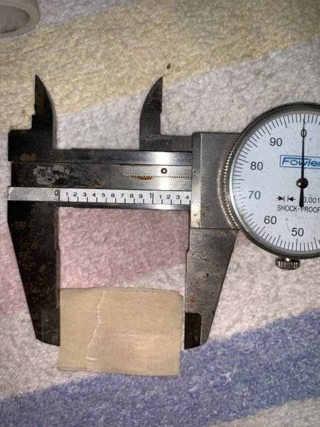

Well the plot thickens. The replacement came. The rotor on this one does not seem to be riding quite as high but it is still arcing up from the top of the rotor finger to the bottom of the terminals. Since I now have a second dizzy at no cost even if I send back the the other, I figured I’d experiment. I ground the top of the T bar shaft down 1/8” and got the rotor seated that much lower. Fired it up, still runs fine, but after 10mins of running still see NO arc witness on terminals in the correct spot. Then I stumble onto what I think might be the problem. Eyeballing the rotor center point (by the carbon dot mark on the top contact tang) if you align that with the carbon button of the cap the rotor finger is 3/8” short of reaching the terminals. I confirmed what I was seeing with calipers, the rotor is that short. In this arrangement the only possible point that it could fire across would be the top edge of the rotor finger up and outward to the inside bottom of the terminal. This is a head scratcher.

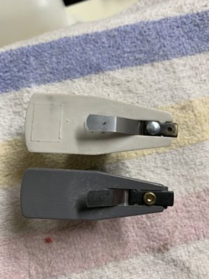

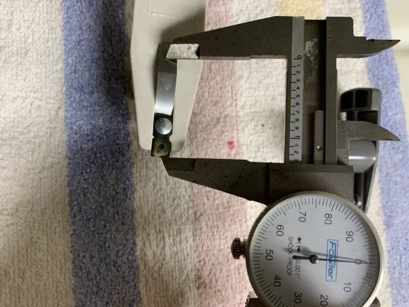

Totally mind blown. I bought a cap and rotor kit, comes in the same box and it’s still WAY short. Pictured are:
Old rotor that came with MP dizzy is white, the Duralast gold part store one is grey. Shown is measurements with a mic. It’s rough measurements but show what I mean, it’s .1000 short each way. In this arrangement the only path to arc is up and out on an angle to the closest point, the bottom edge of the terminal.
