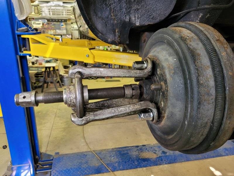

If it's only the rear brakes there could be several causes. It won't be a master cylinder issue. It won't be a brake pedal not returning. As both of these would affect the front brakes as well. Possible causes; The flex line to the axle is internally damaged not allowing fluid to return to the master. E brake cables siezed. Brake shoe material is detached and rotating in the drum on top of the other brake shoe. Removing the drums will tell the story. Unfortunately your screen name is 62 Plymouth. If that's the case and the car is stock it requires a special puller to remove the rear drums.
Doug
