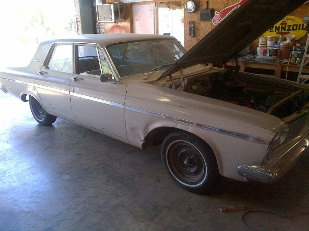

So this is a family car, my great grand dad bought it new, the only fancy thing he paid extra for was a heater.
Here's the car
Wow that looks clean! What are your plans for it? Is that color coral gray?
So I'm going to restore it completely and drive it every day. And I'm going to keep it all original, except maybe the paint. I never much cared for that weird beige/coral color. I want to paint it in a high gloss black but I don't have the money for that anyway.

If you take a look at the 62 in my avatar, it was originally coral gray as well. When I did the bodywork, I went with ermine white. Mine was in my Moms family since new and virtually untouched and rust free. I planned to keep it the stock 318 2bbl but the further I got along the more I wanted to do to it. Love the way it runs and drives now. It sure is a lot easier to fix one up when it hasn't been screwed with. You'll have fun with yours.

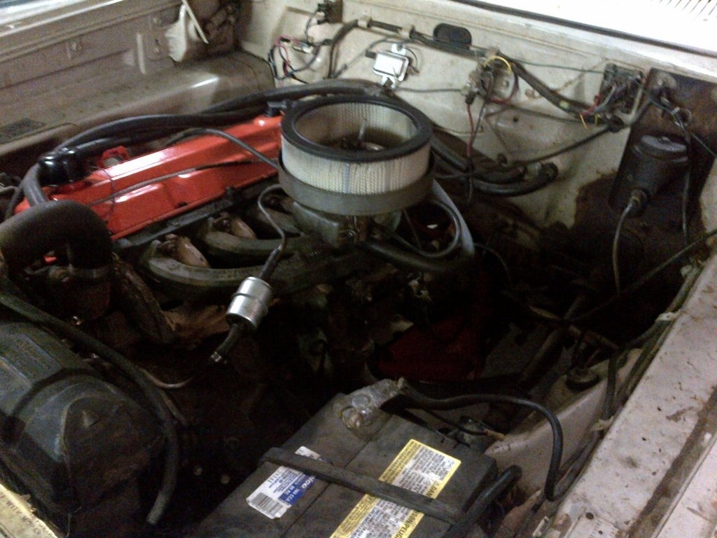

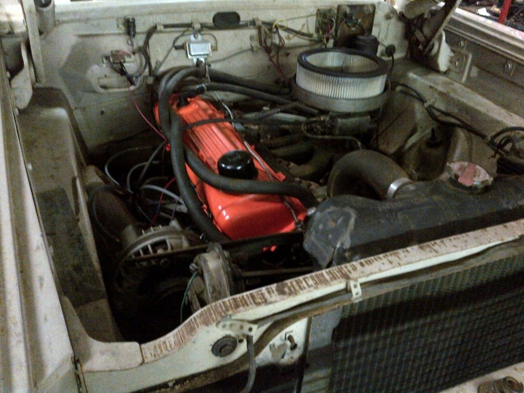

So it has the 225 ci slant six, which was the milage engine anyway. And the best thing you can do to one of these engines is swap the old 1 barrel carb for a good holley 2 barrel.
So here's what I've done:
I swaped the 1 barrel for a 2
Replaced the internals of the distributor for electronic ignition.
I did a clutch swap because the clutch was destroyed.
(Keep In mind that I still have all of the factory parts so its still a matching numbers car)
And I've done crap tons of tuneing.

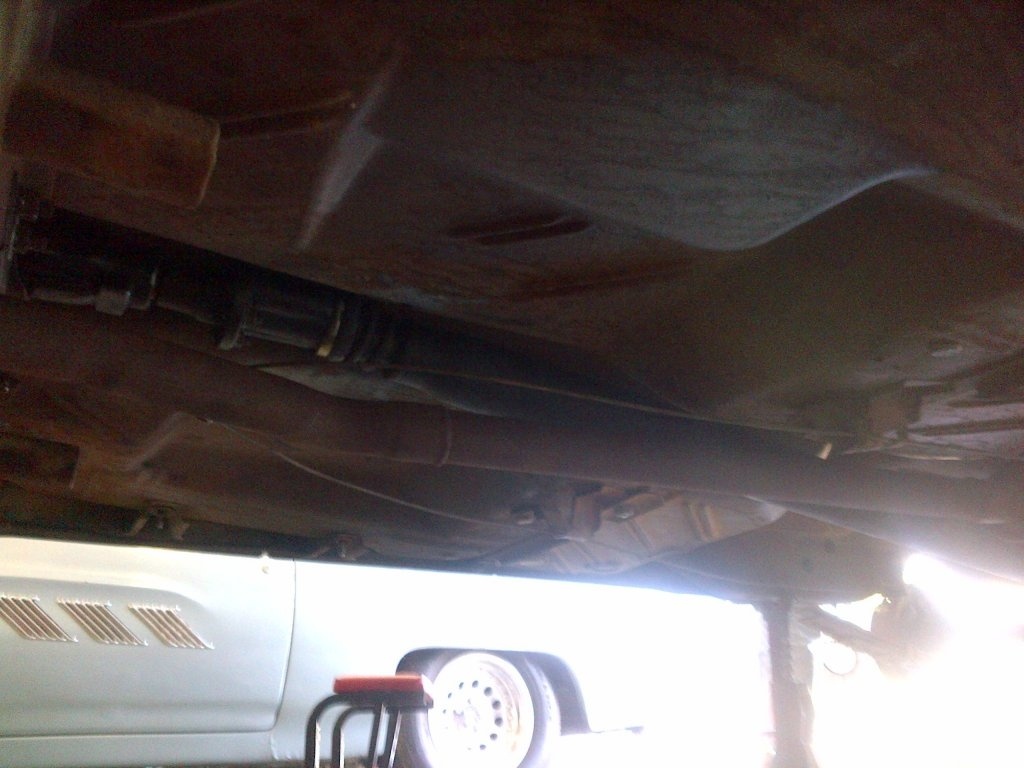

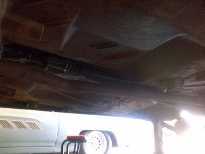

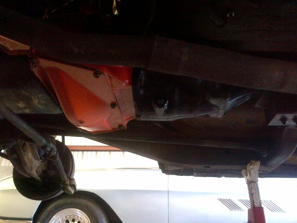

I also still have all 4 hub caps, I forgot to mention that. When I had the trans out of the car I scraped washed and painted the trans and bellhousing, at the same time I sent my driveshaft off to a relative to have the joints rebuilt. Up next is the pinion seal in the rear axle

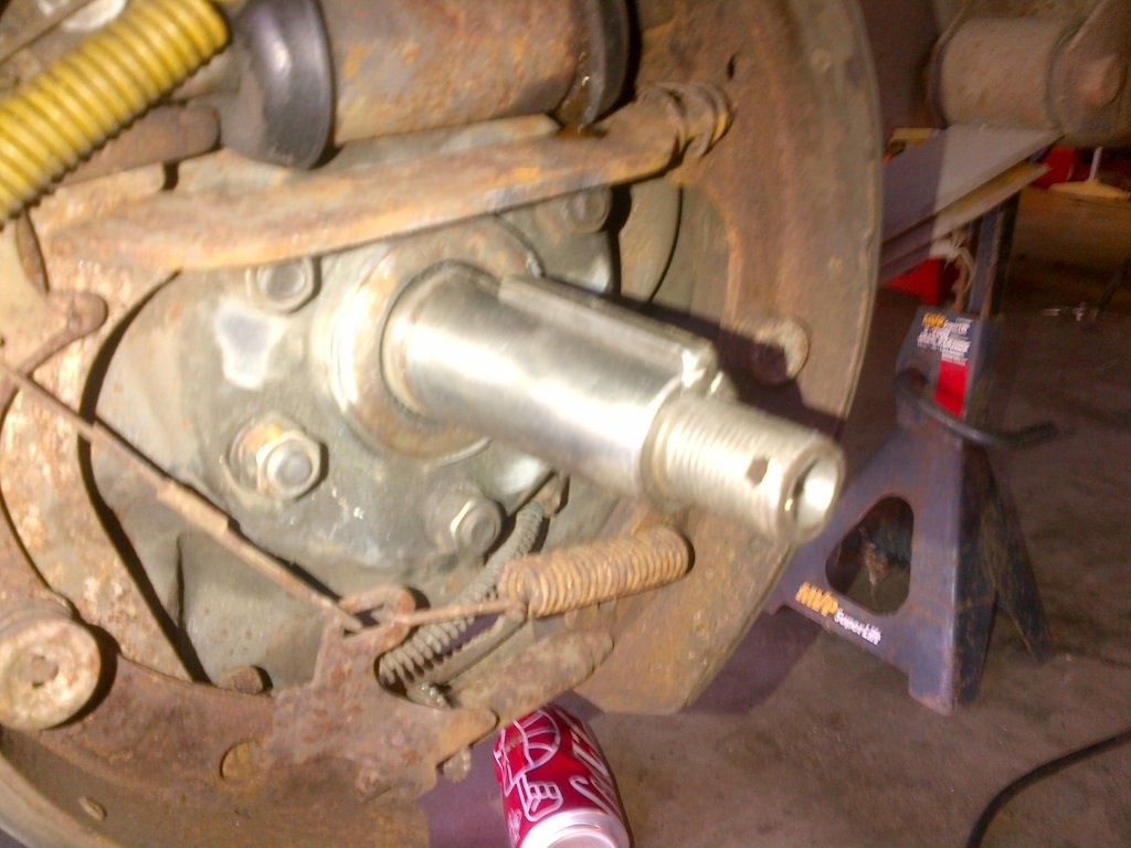

Ah yes, tapered axle shafts, time to get out the torch! I actually broke a hub puller trying to get the hubs off. Anyone else feel my pain?
Never had issues with mine. There is a three arm puller specifically for these hubs, always worked for me.
