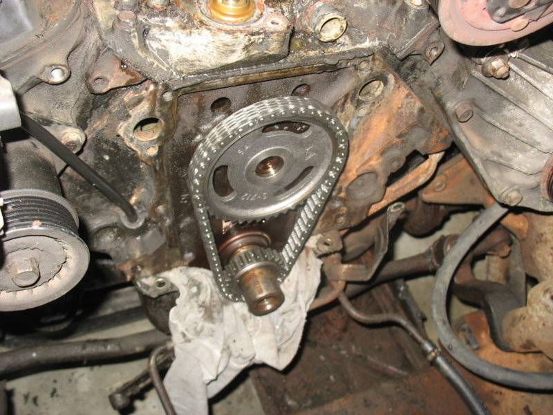

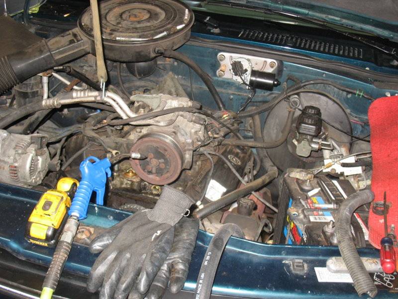

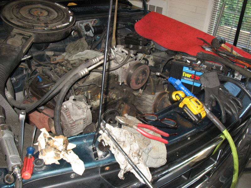

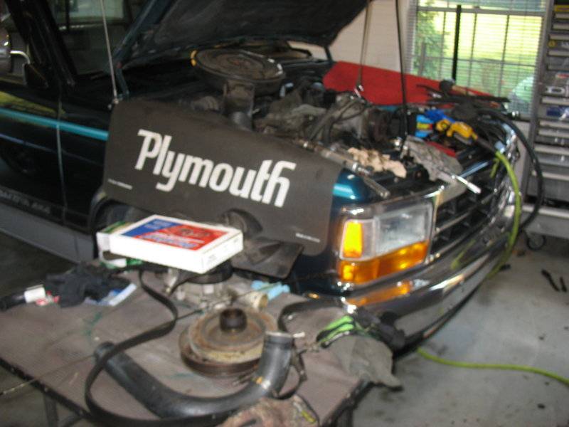

Timing chain leak on my 94 Dakota. 3.9 V6
Local shop wanted $712 + tax and shop supplys if I supplied all of the parts.
I decided to do it myself.
Timing chain had about 1 1/4 " of play so a new one was called for.
Front main seal which attaches to the timing cover is shot and it is part of the oil pan gasket so now the pan has to be dropped.
I have a lift but no way to get it on because the engine is now apart so I'll have to work on my back.
Happy days.

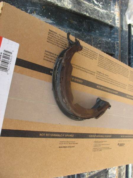

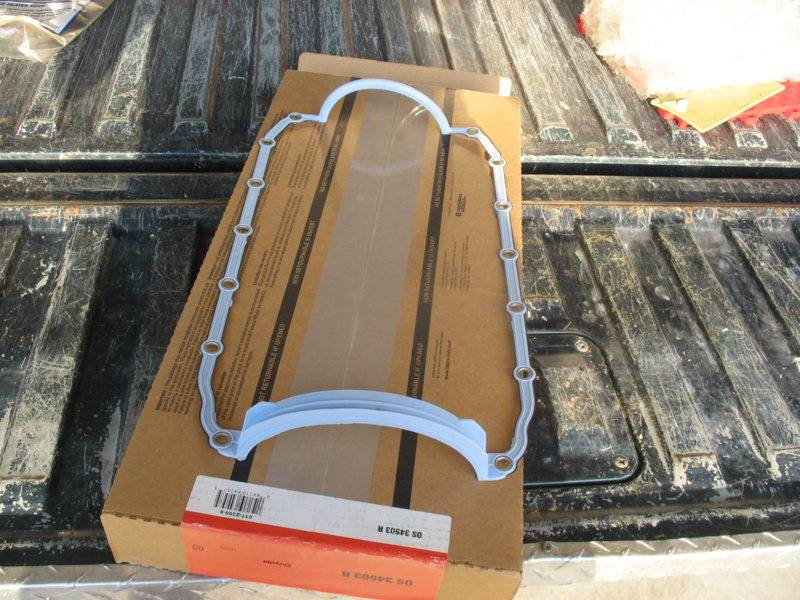

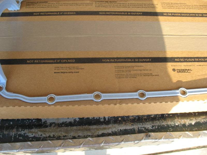

I briefly had that thought till I went and picked up the $38 pan gasket, I asked the parts guy and he said don't even think about it. Check out the pictures.

Update................. No fricken way to get the pan off from laying on my back.
I forgot to mention that it is 4wd. skid plate, sway bar, cross member all have to be removed to even consider getting to the pan bolts.
I'll have to cut the pan gasket and use RTV the best I can.

I'm going to get it back together and drive it on to the lift and buy another pan gasket. If it doesn't leak then I will not need to get it on the lift.
