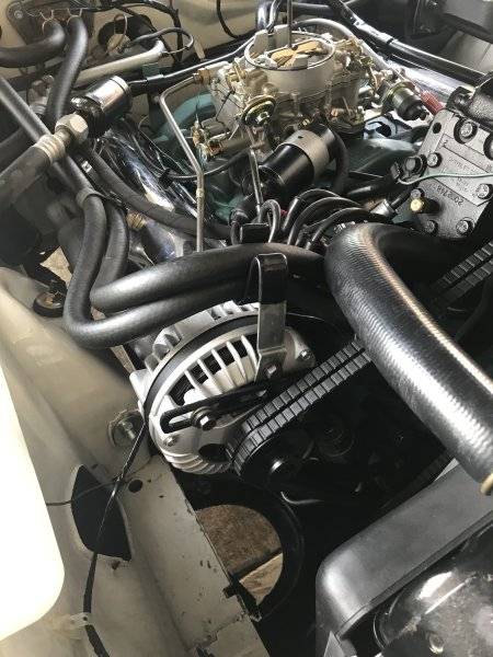

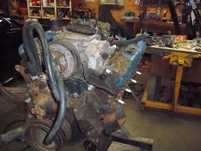

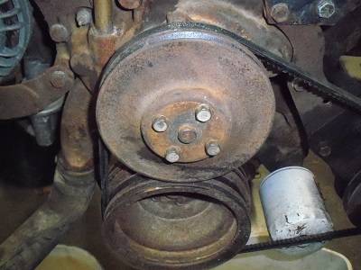

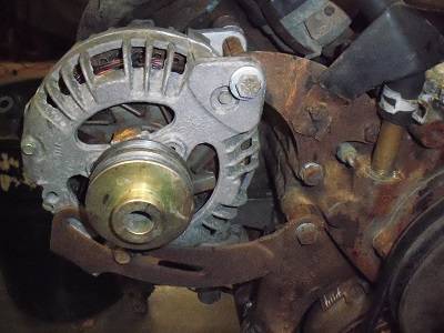

I purchased a powermaster 8-48529 alternator as this should fit my car, well it doesant :p
Seems like the A/C cars have a different bracket than non ac.
Has anybody been down this path before? I cant find any kits to make this work.
Picture of old / new alternator and original bracket.
Thanks
That style powermaster is not going to work with that style mounting. You need the round back style powermaster.
thanks but i dont think that will work since the car has 2 belts, i guess thats why i have a different bracket than what the alternator was designed for. The alt. was recommended to me by tech at powermaster and should be a bolt on with 2 spacers.

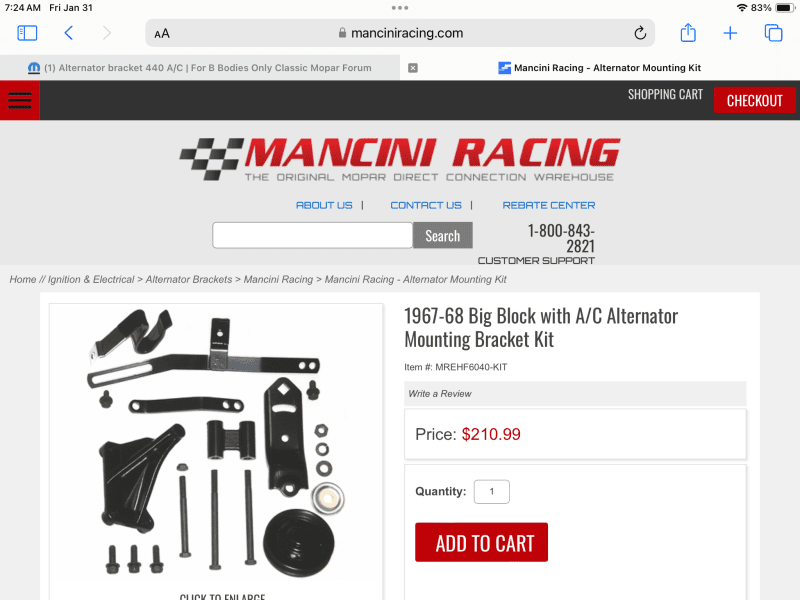

I spoken to mancini, 440source & bouschillion performance and nobody can supply a bracket that fits my car they said. If you know about something please let me know :) to me it seems the AC(2 belts) makes it difficult to mount something standard.

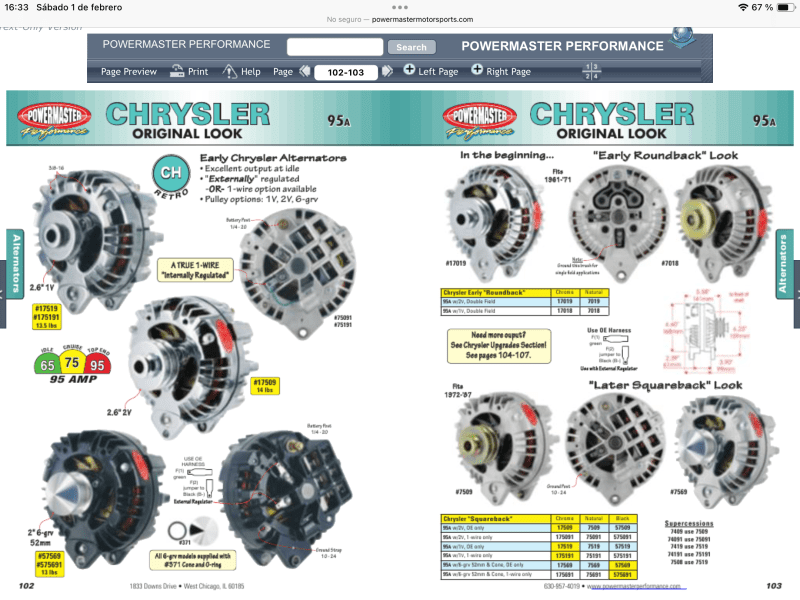

There is a German distributor for the PowerMaster 7019
Alternator Mopar 95 Amp till 1969 round back, dual Pulley, 298,88 €
I bet your car won’t need more than 65 amps at iddle IF is fairly stock with just some upgrades.
Is not straight ONE WIRE alt like the one you got (later GM design alt), but is ready to be used with later factory dual field setup electronic Mopar regulator. If you want to use the factory reg for 68 one field setup, just will need to reuse the factory grounded brush you already have on your stock alt or ground one of the brushes that one gets.
To “become it” into one wire alt, small mounted on regs are available. These are the ones used on most Mopars “one wire” conversions alts available. Same shop get those

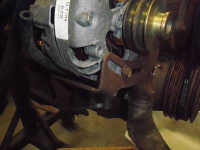

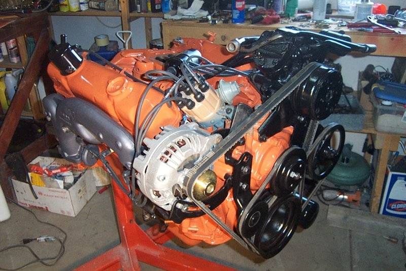

The deal with the alt setup for 69 and laters with A/C brackets setup (like Pnora and 1967Coronet shown) is the diff upper bracket position between A/C and non A/C. When A/C is present, compressor bracket uses the bolts provisions used on non A/C alt brackets, so the Alt bracket had to be moved on to a deeper disposition. This makes the alt front provision mounts IN FRONT of the alt bracket. So even if you want to use the alt you got, get the alt installed like laters setup wouldn’t be possible due the one piece large alt provision for the top mounting design used on these later GM alts (the design of the PowerMaster alt you got)
