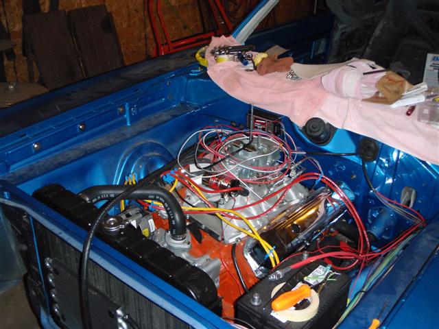

I am running a small denso unit i believe it was for a mid to late 90's impalla ss. took a little figuring to find the correct model and wiring but it works great it is 105 amp small and fit right in the factory spot with very little effort. You should be able to see it in the pictures on my build thread just search my name. If you are intersted i could get you the information and wiring instructions. after the weekend not sure if i have them at work but maybe. PM me and i can get you everything if you want it is a very clean and nice install and the plugs are available at oriley's, carquest or nappa.
This is the best pic I have.
