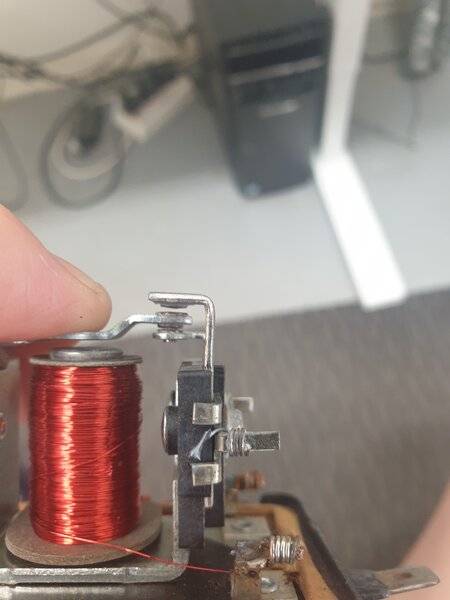

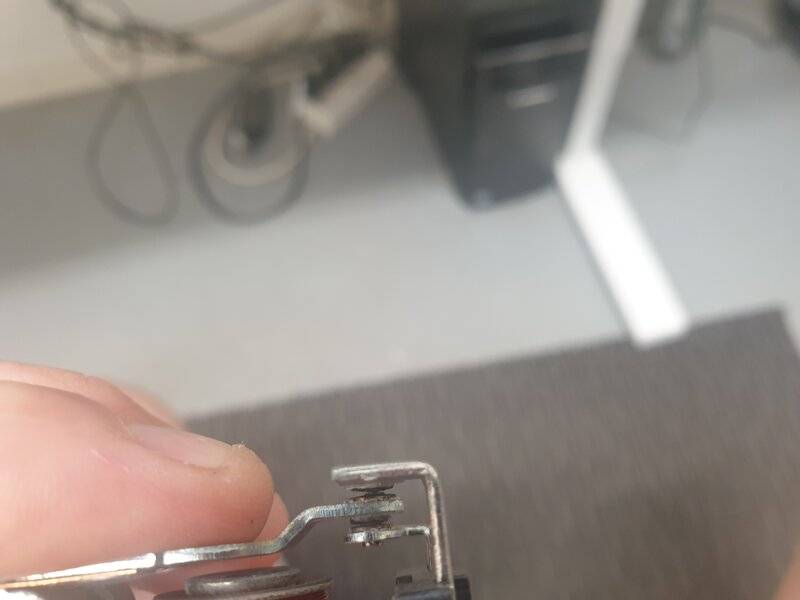

I took the voltage regulator off and the points had a lot of carbon buildup and were hardly moving. I cleaned them up and they move freely - I thought I had the problem licked, but no, still the same issue.

First photo shows points before clean.
After cleaning

Any Chrysler isolated field, externally regulated, alternator can be easily made to work for a pre-’70 mechanical regulator application. For this situation as described, I would start with a full field test, if charging voltage comes up immediately at idle, it would indicate a regulator issue. You can get electronic versions of that regulator that would be more reliable.
If there is no change in idle charging voltage while full fielded, would indicate something has changed with the alternator output capacity, i.e. diode failure.
