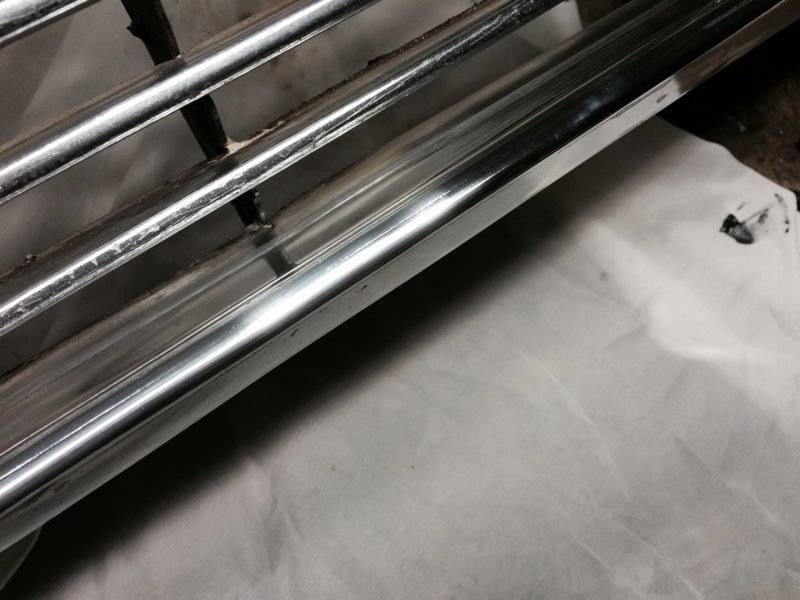

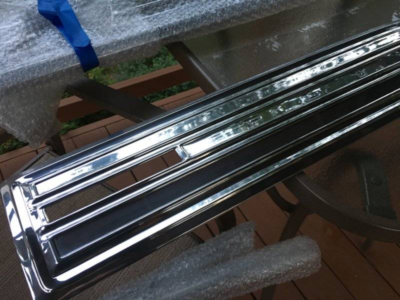

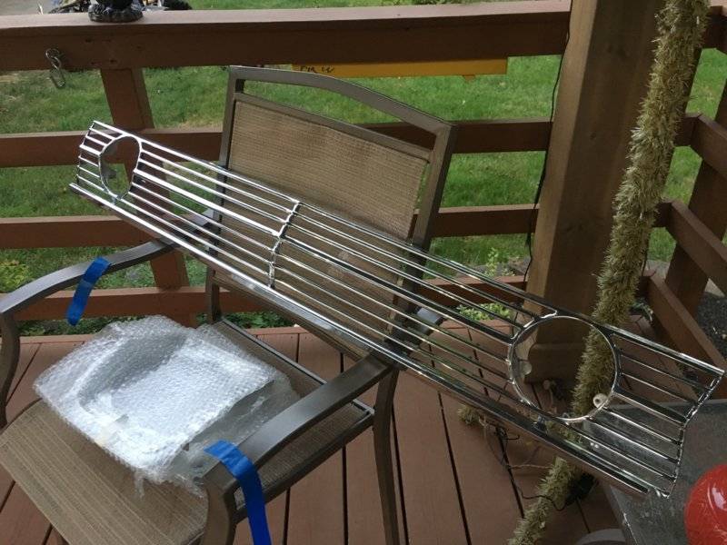

I recently removed the anodizing from the grill and all the aluminum trim on my '66 Belvedere. Did all the necessary repairs, sanded and polished. Then started to look for a company to anodize the parts, at a reasonable cost (good luck). In my search I came across an interesting article -

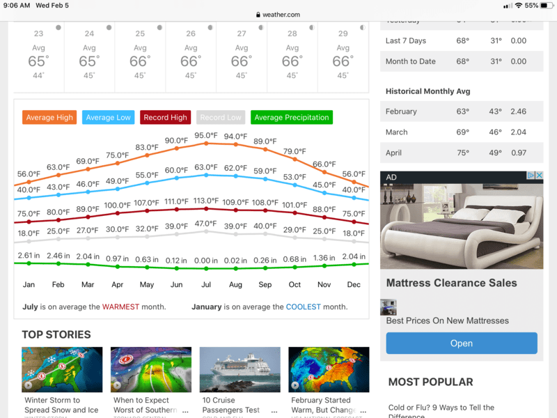

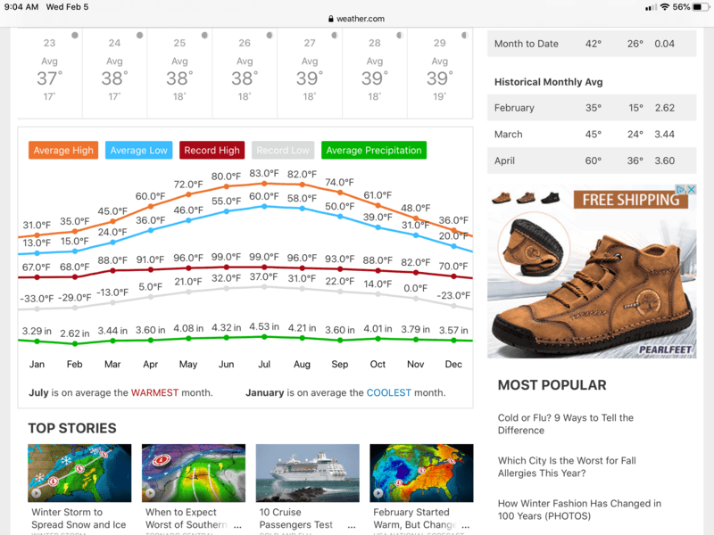

Your polishing schedule could vary with the weather. We don’t need dehumidifiers out west. I got a whole new appreciation for humidity going to Carlisle, PA in July, WOW!

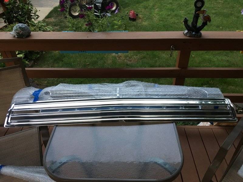

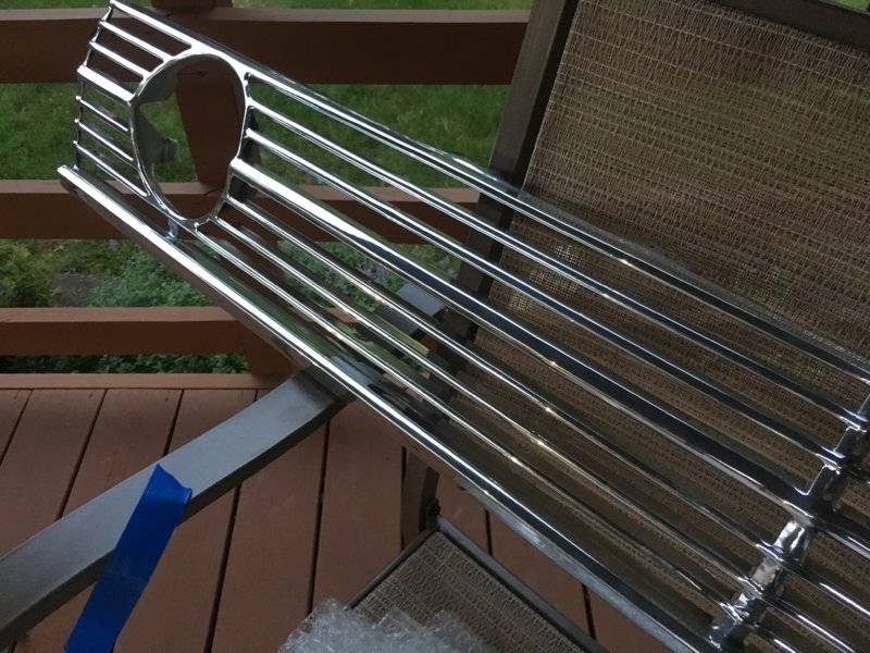

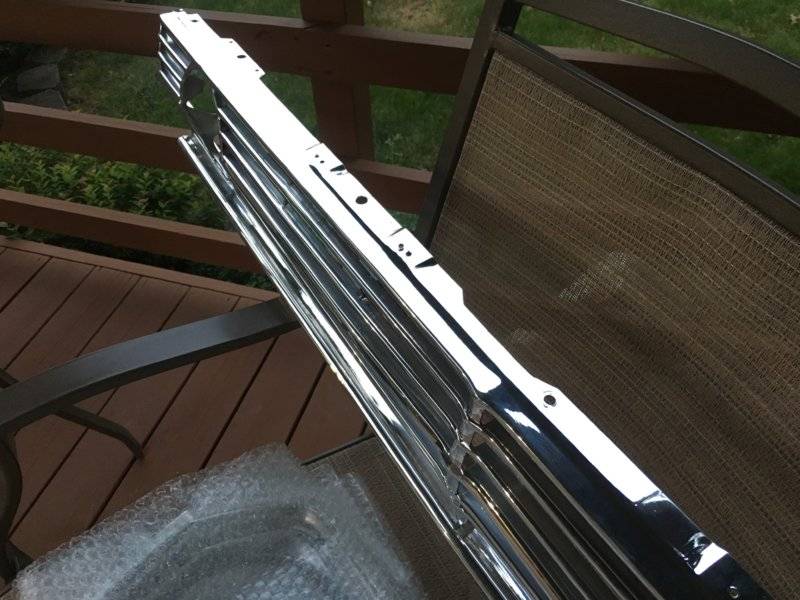

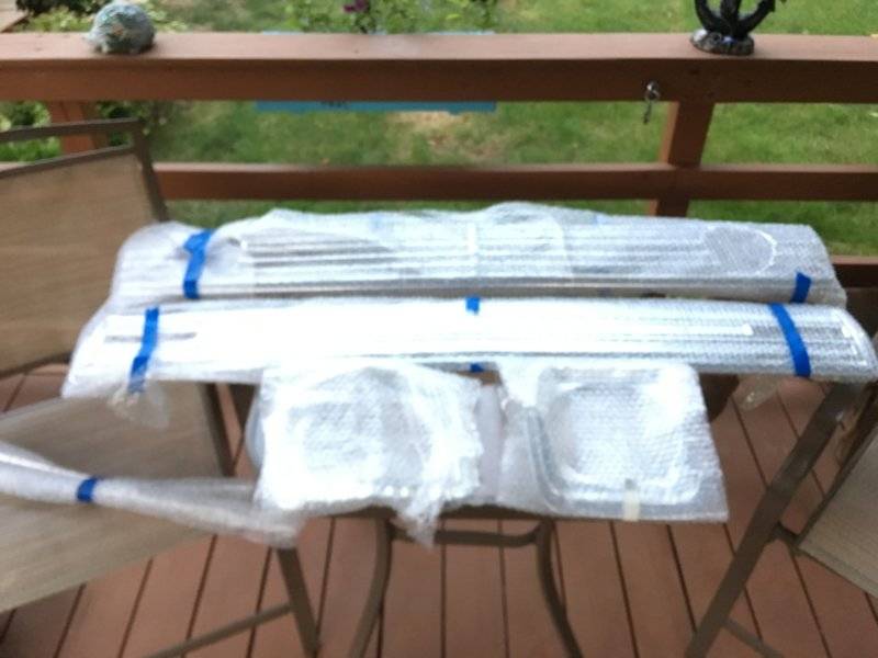

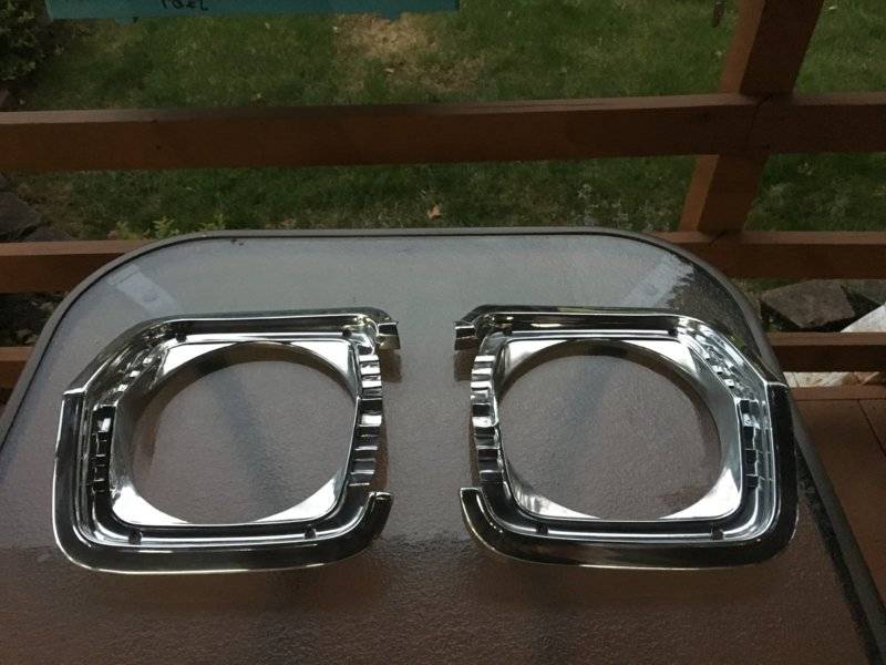

I had the anodizing stripped and polished. I wax/Detail spray it a lot but looks fine for about 2 years now. Did the trunk panel and wipers also..
This price was pretty fair considering the work done. About $450 for everything. George (GTL Polishing)
PM me if you want his number.

I have my 68 Satty headlight bezels at Cuda Chicks ( Leanna) Was going to get mine anodized , but the only place I could find was Iverson's-Very expensive . Leanna told me she uses a clear paint that is the toughest she has been able to find. I don't remember the name of it, but she is going to polish and clear coat mine. I did have mine clear coated with what you use with base coat paint, but it started peeling off.............MO
I would not put any coating on it. Just polish once a year and your good. Clear Coatings (no matter what) will come off and ruin your day. It can not be reversed easily.
