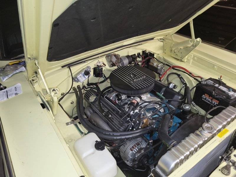

My car has the Stealth heads,
Was told approx. 9.5 comp, the repop sixpack style cam and stock HP manifolds and TTI 2.5" exhaust.
I'll be honest. I don't have a lot of details on the engines build. But I do know the car runs Good, REAL good.
