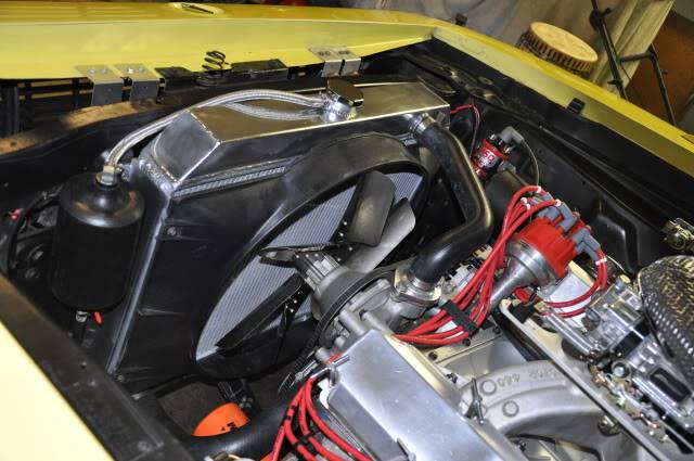

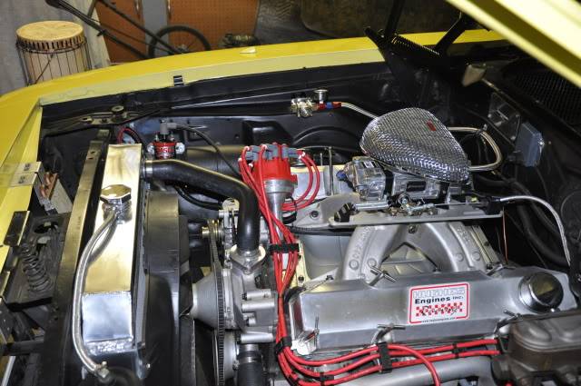

stock shroud painted silver...direct fit on the schroud also
Champ in mine as well, but need the fan shroud, is that the stocker for 26" rad? I see you have the flex fan too as do I
yes stock shroud from Jim's auto parts part# P2998326 $ 84.95. Bolted right up no problems.
