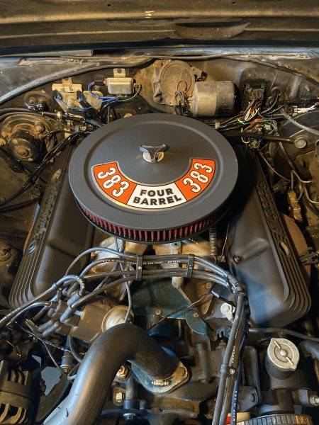

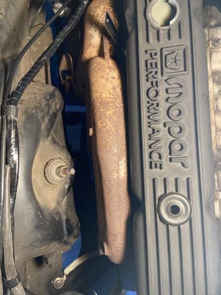

I’m honestly not sure if they’re cast or stamped I bought them at the Indy fairgrounds MOPAR swap meet. Is the clearance going to be OK?
Those are CAST. As others have said, tighten slowly and evenly. If the flanges on both head and cover are FLAT and clean, it won't take much to seal them. I like to build a base of Blue Loc-tite on the bolts, and in some cases use studs and serrated nuts.
I’m using these gaskets they have a metal middle and reusable. Just not a lot of clearance on passenger side.
