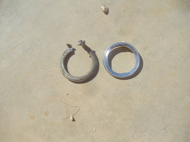

OK, the supplied/installed gaskets on the Champion plugs are perfectly round on the inside diameter which means impossible to thread them on or off. The just spin and trying to start to pry them off with a tool is not a viable option. The replacement gaskets do have the four mini-tabs that provide for threading (you have to look real close in the foto to see them).
