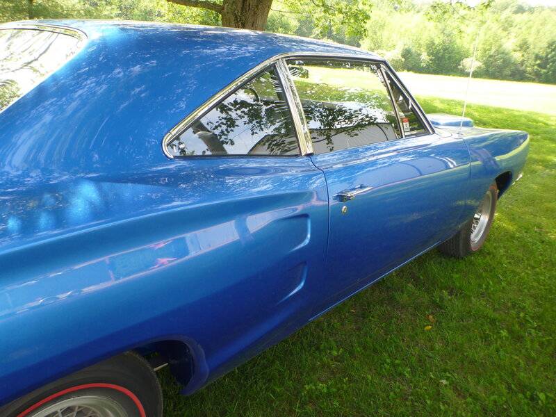

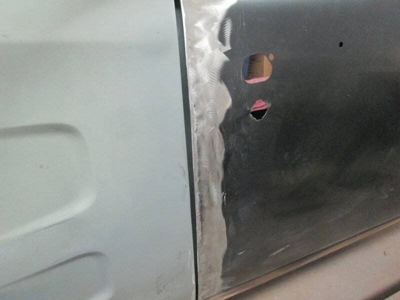

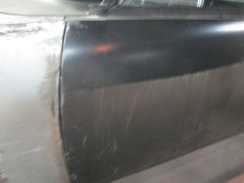

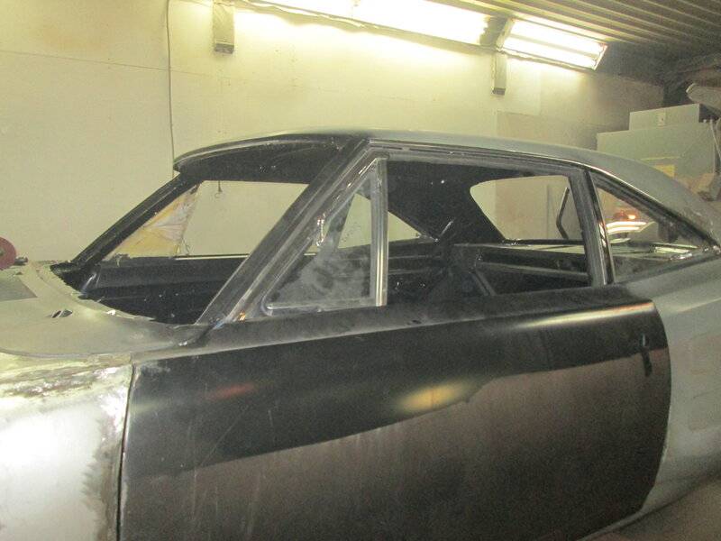

Both my doors are done with new AMD skins on my '69. If I remember correctly the skins where only $400 Canuck dollars each.

Beautiful! Thanks for the picture. They seem to line up really well. I was thinking I would be best off rebuilding my hinges
first, and hanging the frame on the car to tweak the skin alignment before spot welding it.
Yep, make sure your hinges are good with the original door. Set the original door up nice and then drill a pilot hole in each hinge for line up. Then get the new skin folded over and into place on the door shell, door hung using the pilot holes and move the new door skin around any to line up. Then clamp and weld in place.

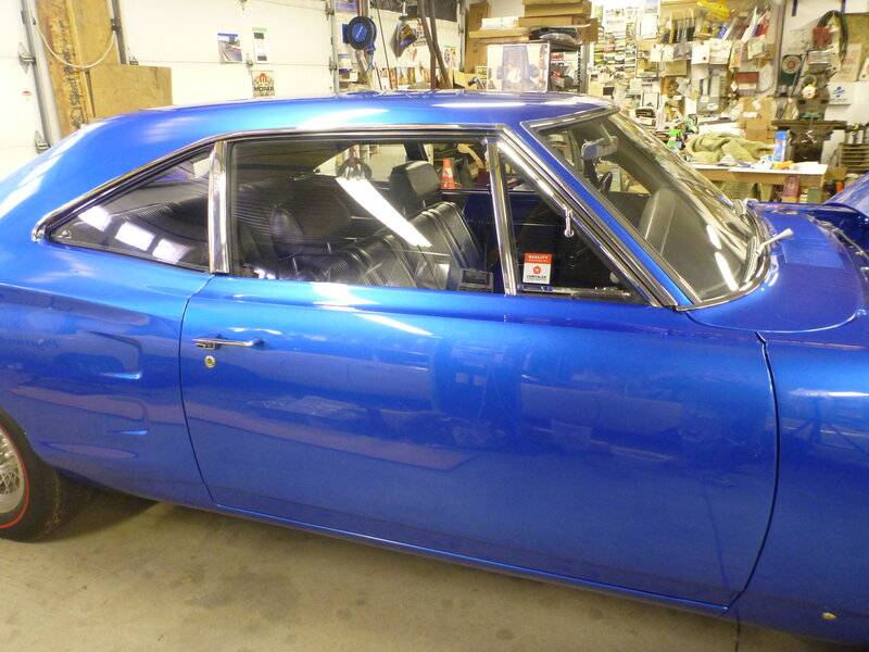

Good advice on the pilot hole. Thanks again for the pictures, gives me hope that at least mine *could* turn out ok, but with me doing it....
