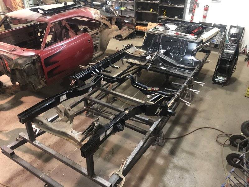

It's going well, getting closer to paint. I don't have any of the rails that I pulled out of the car anymore. The rears of my rails had some pinholes anyways so I changed them and scrapped the originals...
