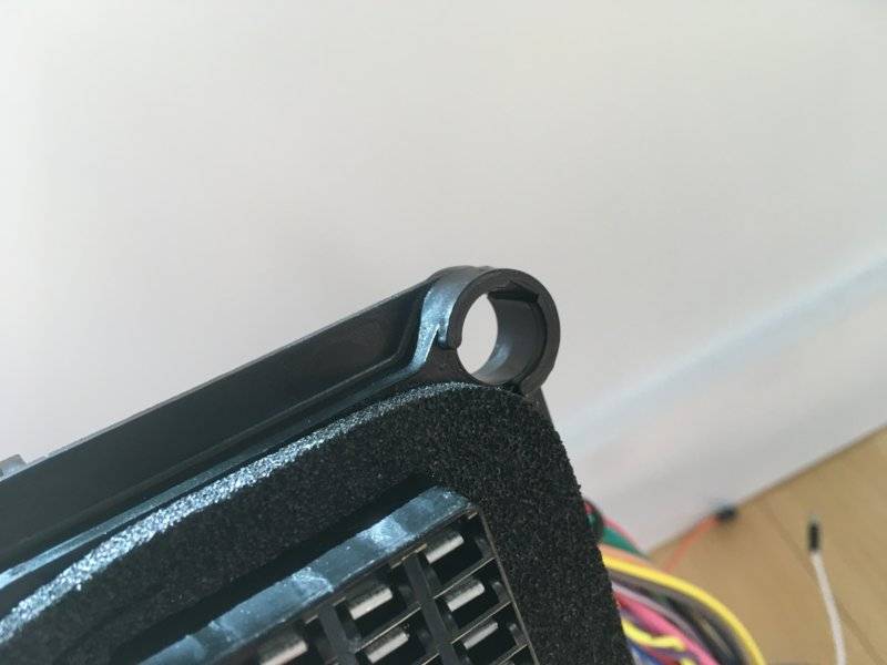

Unfortunately, when I opened the bag to inspect the main dash harness, I found that one of the mounting tabs on the replacement 'bulkhead' connector was broken off. I hate returning stuff but no doubt it would be warranted here. See the pics below.
Broken tab.
Good tab.
Now, I know it's not a huge deal but this is the main connection point for the entire harness. It looks like it will 'probably work' but I won't know for sure until I actually mount the thing. My concern is that it won't be able to sit flush against the firewall even though there are pretty big screws provided to hold it in place. There's still some of the locator cylinder left, maybe it'll be enough to keep it from rocking.
I could ignore the broken tab and move forward but I'm not in a rush so maybe the wise thing to do would be to return it. Have not opened anything else yet.

Spoke to their tech line, won’t e a problem to use it as-is. It’s pretty much up to me whether I want to pursue a return with Summit. AAW said they would send me a new connector but that involves me re-pinning the entire thing. I’ve done stuff like that but I’m not interested in getting involved with it here.
Still on the fence but if I know myself at all I will hem and haw about sending it back for a couple weeks then will wind up using it anyway.
Decided to keep the harness and use it as-is. As I expected, I hemmed and hawed but in the end it wasn't worth the hassle of boxing it back up.
