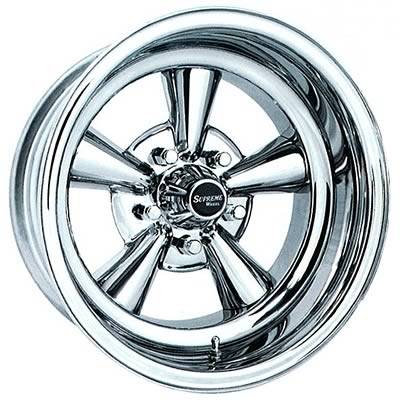

Thought about these........US Wheels, made in the USA!
check into halibrand. they used to have variable backspaceing. i almost bought a set and wish i had. ebay used have some, but they're getting pricey.
