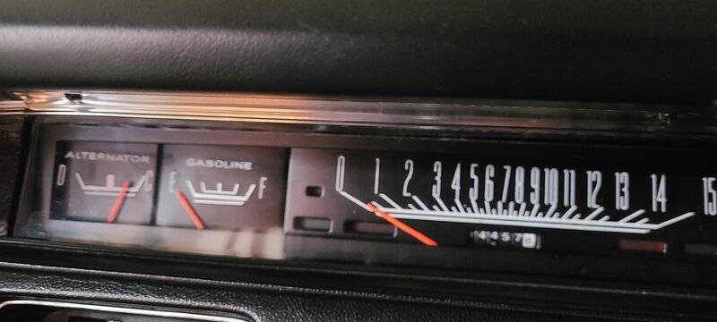

OK, pulled the cluster out. Removed the ammeter gauge from the housing. Very simple mechanism. You guys are correct it was just whorked because of the arc'ing. Just moved the little pendulum in there a few times and it started correcting itself to center. Put it all back together...worked like a champ. Crazy.
