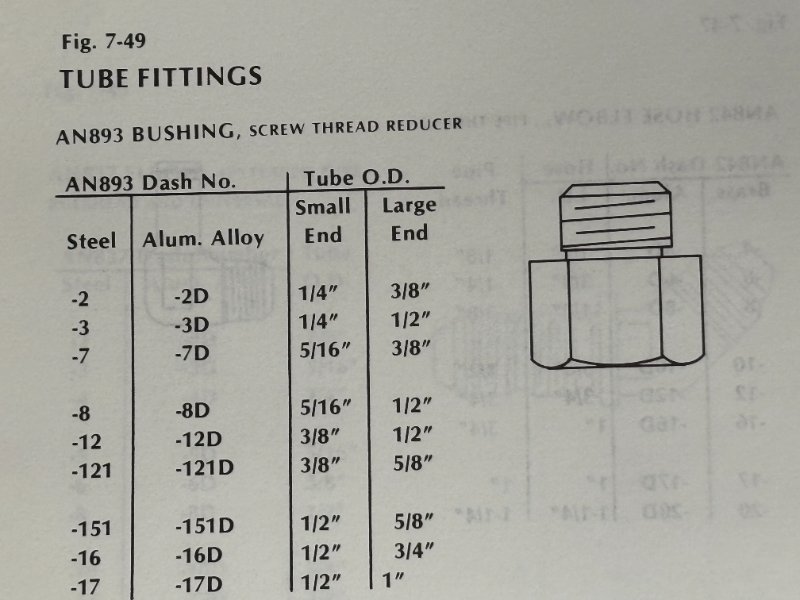

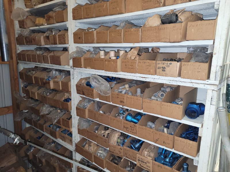

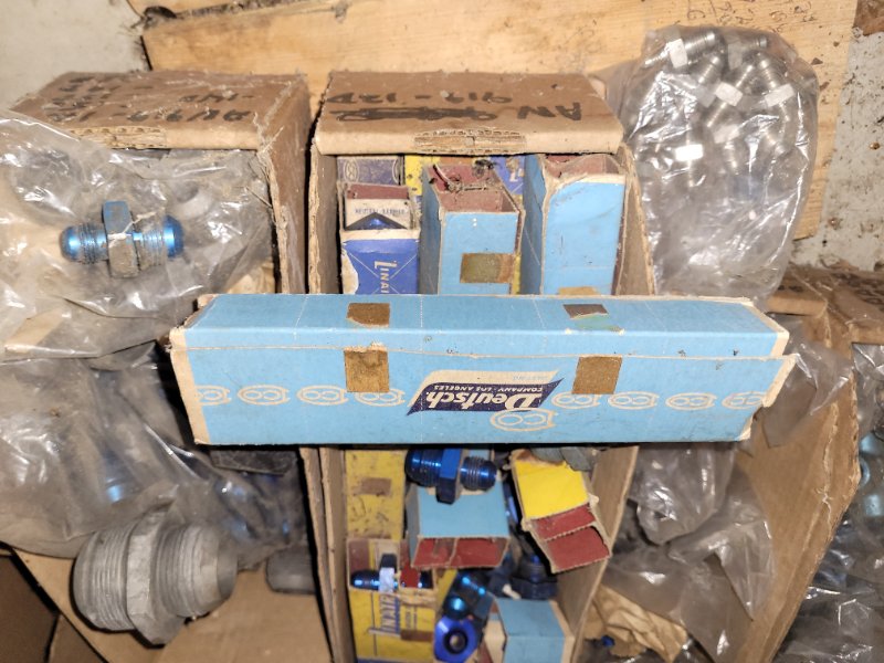

That should flow enough fuel!Oh I'm well versed in AN fittings. Dug thru them all and someone seems to have taken my -7's. You are looking for an AN919-7. Steel is -7, Aluminum -7D and Stainless -7S.

Are you using a Enderle style log regulator made for mech. injection?, it's the little log with the spring to regulate pressure past the point of the carb feeds. I tried this on my 64' with a large Clay Smith mech. fuel pump putting out around 12psi . Didn't work well, pressure fluctuated and wouldn't stay steady. I gave up and used a regulator and dead heading it. I do have that electric Carter fuel pump on a truck and it does not have a regulator and is dead headed, works great, holds a steady 5.5 psi. I'm curious to see if your set up will work well since you are using a lower pressure pump, maybe it won't fluctuate?. Please let us know.Thanks all! The AN919-7-7d male to male black will work with an added 6an to 6an female to female coupler.
