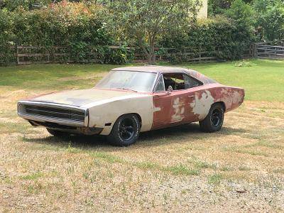

I'm rebuilding the original engine in this car:
It is a 383 2 barrel. It is virgin bore with original pistons, steel crank, 727 trans and 3,23 gears. I have other ratios I can use including 3.55s and 3.91s. I put a 3.23 chunk in it just because I had it handy.
