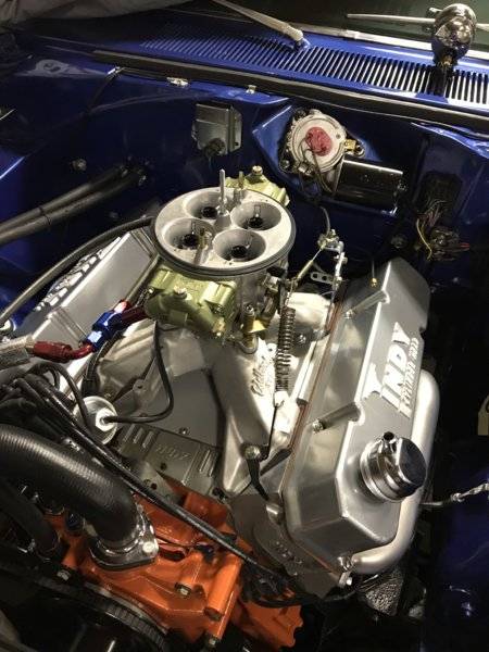

this one is super clean.

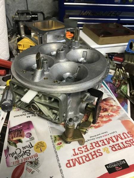

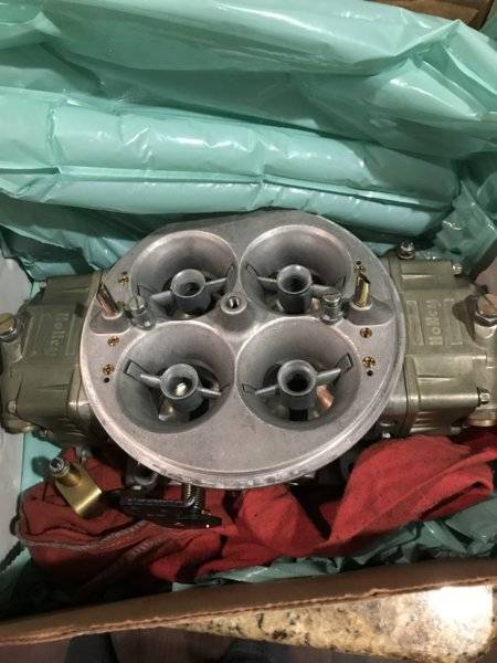

First stop, booster swap!
Well? What did you change and why? I need info :popcorn:

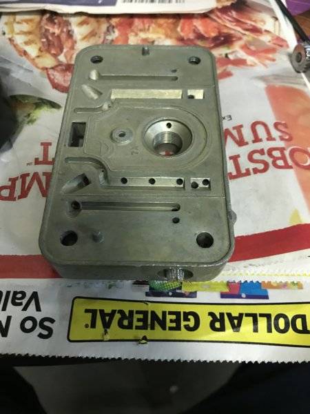

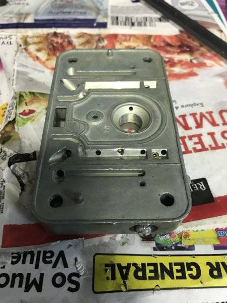

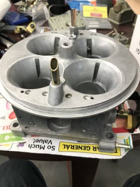

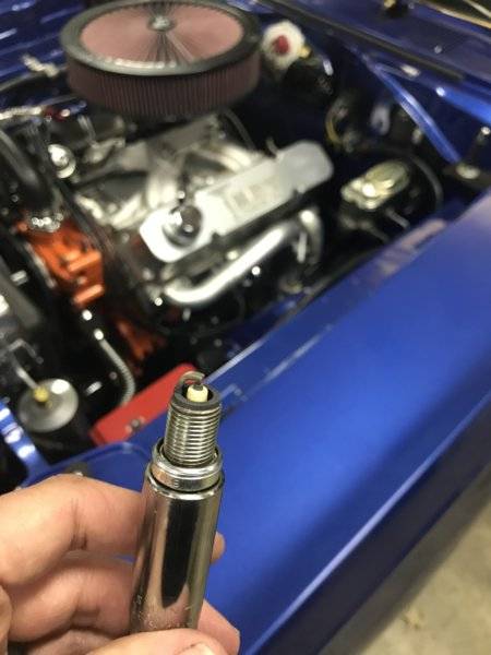

Lowered the IFR’s, reduced the emulsion, added TSR jets, increased the IAB, reduced the MAB, and converted to 16 hole annular boosters. Now I just need to fine tune it on the car. Reasoning, to build a clean running dominator that drives around like a 4150 carb, gets decent mileage, and when you pull the plugs they are nice and clean.

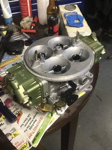

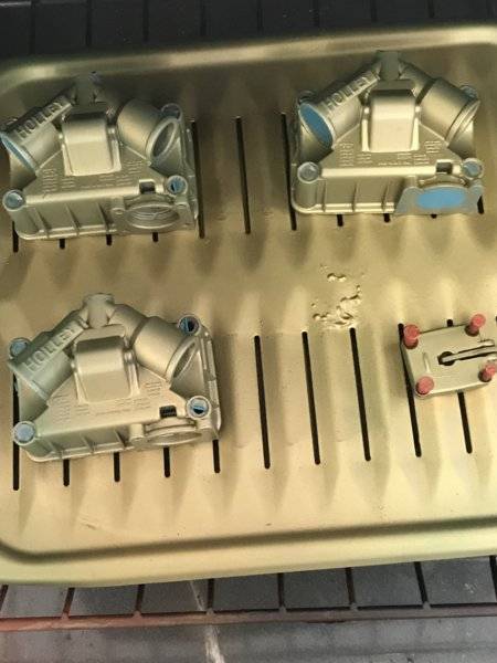

Green float bowls??
It’s some powder coat I’ve been playing with. It’s gold with a green tint. Suppose to mimic the factory finish. It’s close, just looks a bit more intense in the picture.
That's what I like to see. :thumbsup: Thank you.
I never played around with Dominator carbs. I have much to learn.
I’ve got some drive time on it now. I gotta say, it really runs sweet.
