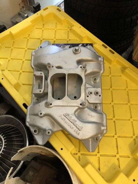

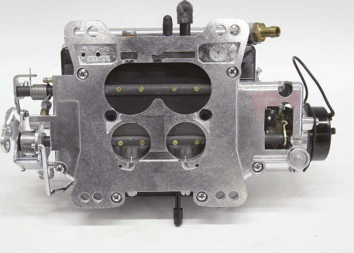

Technically not a spreadbore, just small primaries like one. I figured it would be better for economy at cruise. Actually the manifold will accept either.

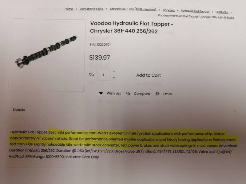

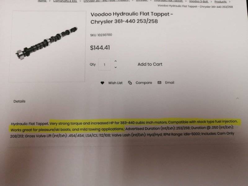

I was looking at the small summit cam. Here are three other candidates. (sorry a bit hard to read, click on them to make larger)

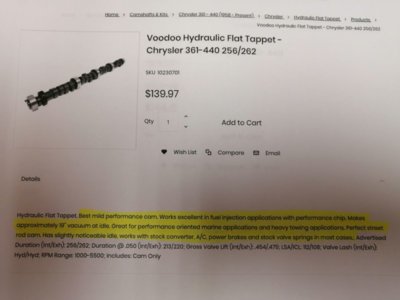

I kind of like the description of the Voodoo 701 cam too, good vacuum, works with PS, PB and A/C. The 1000-5500 rev range sounds good too. The tires are 27 inches tall, which gives me around 2500 rpm at 60 with the 3.23's.

I agree with small primaries, the original AFB on my 66 383 had the small primaries and it had terrific throttle response.

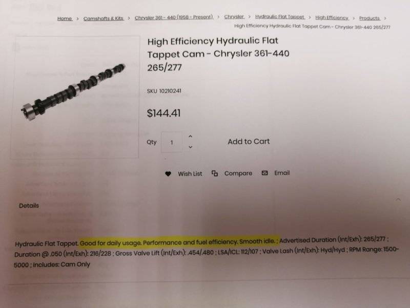

I used this Crane split Hyd. in a 318 a long time ago. It was very good and has the same description. My P/B worked excellent. I also had 3.23 gears on stock sized tires on a low compression engine/904 trans, headers, 600-4bbl. NO converter change needed. Good cheap thrills. The lil’teen ran high 14’s. 19 mpg’s Hwy.
https://www.summitracing.com/parts/crn-693941/make/dodge
216/228-.454/.480-112
The Lunati would be chooses now. 1.6 rockers employed.

Lunati 700 or 701 for cams in the 256 range best choices
10200700 253 208 .454 VOODOO best shelf cam 112LCA
Lunati 701 256/262 213/220 .454/.475 108 LCA you do not want the narrow LCA increased overlap

FWIW the 701 is ground on 112 lobe centers also, but installed at 108. I tend to agree though, that the shorter cam may be the better choice, plus the 454 lift will cause less issues with guide clearance if I don't end up removing the heads, and anything over 454 lift on those 516's is going to be wasted effort anyway. I have to try to resist the temptation to go bigger, my drag racing roots are showing.
