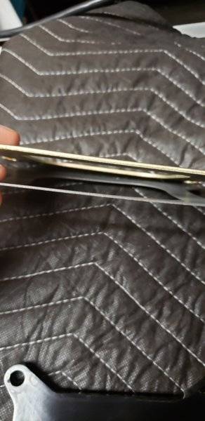

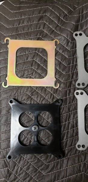

Sorry yall..busy day..
On top is the questionable plate...the spacer below.
Second pic shows thickness...not much..lol
One came with my intake ( 440 } also. They way I understood it was the plate was to go on a gasket 1st then another gasket , then a sq bore carb , eddy , holley ect. spread bore carb didnt need the plate.
I would say your spacer would serve the same mounting style.
The new preformer intakes have a empty area on the passenger side that that plate supports on a sq. bore.

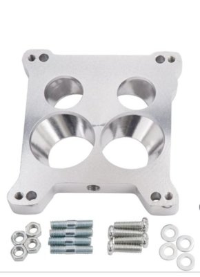

I always got better sealing characteristics from the aluminum style adapter with the socket Allen screws going down into the manifold and the 1inch bolts facing up....just seemed like a smoother transition...but it makes sense as a spreadbore adapter
